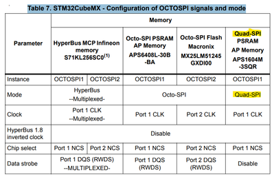

Hello Support,
I am not able to find the QSPI config in the STMCube 1.18.1version. I have attached the snapshot. According to the EvalBord it supports QSPI.
CAN you guide me here for the setup.

QSPI is a subset of OCTOSPI1 here. Configure the OCTOSPI1 peripheral and ensure it uses the pins you expect.
‎2025-06-04 8:04 AM
‎2025-06-04 8:07 AM - edited ‎2025-06-04 8:08 AM
Hello @mani9989;
The OCTOSPI interface is fully configurable and supports two, four or eight data lines: Single-SPI (traditional SPI), Dual-SPI, Quad-SPI and Octo-SPI.
You can configure the OCTOSPI on QUAD-SPI mode.
I recommend you to look at AN5050 precisely "Table 7. STM32CubeMX - Configuration of OCTOSPI signals and mode" , "Table 8. STM32CubeMX - Configuration of OCTOSPI parameters" and "7.2 OCTOSPI configuration with STM32CubeMX" section and get inspired to configure the OCTOSPI on QUAD-SPI mode.
These tables can help you on how to configure the OCTOSPI with QUAD-SPI memory.
