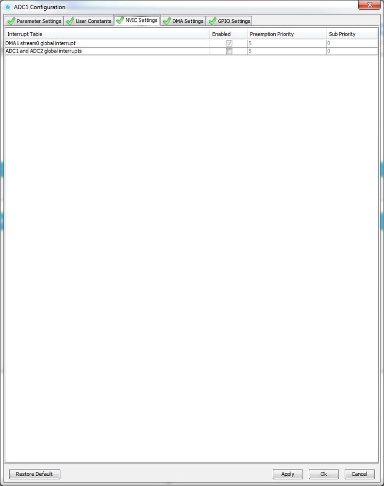

In summer 2017, I started an project with the STM32F767 on the Nucleo board, because the H743 was still announced but not available. For some weeks I got the new Nucleo board of the STM32H743.
After I transferred the code from the F767 to the H743, I recognized the not working DMA interrupt. The DMA interrupt was working on the 767 perfectly. So I reduced the code of the F767 and the H743 (by using cube) to only this function for see what�s the difference.
  • TIM3 managed 4 PWM Signals (22KHz) and triggers the ADC1 on falling edge and call the interrupt call back function. (LED GREEN toggles).
  • When ADC1 conversion is finished, the DMA is triggered and copies the data.
  • When the DMA transfer is completed, the call back function is called, and the BLUE LED toggles
I can�t see, why the interrupt for the DMA at the STM32H743 is not working!
Have somebody done something like this already and was successful?
I put both projects for Cube and the AC6 workbench to the attachment. Hope somebody can help me.

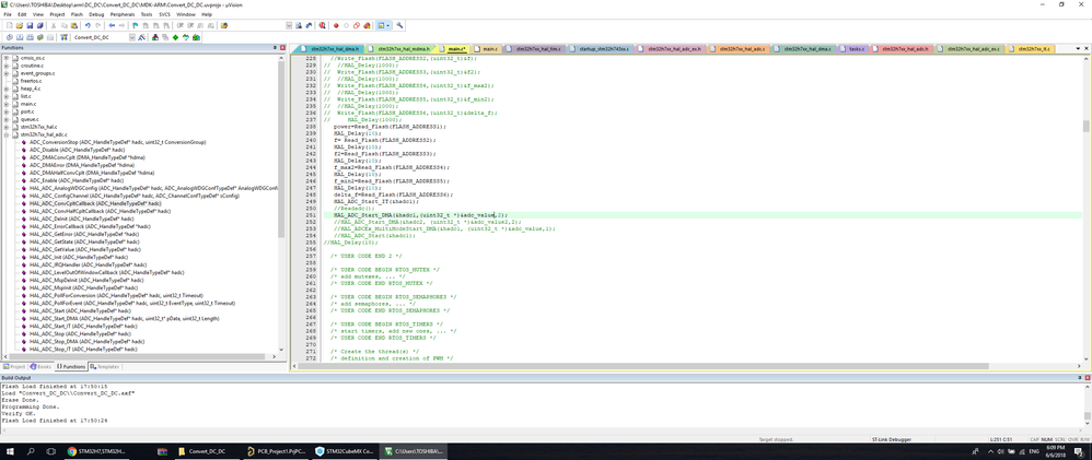

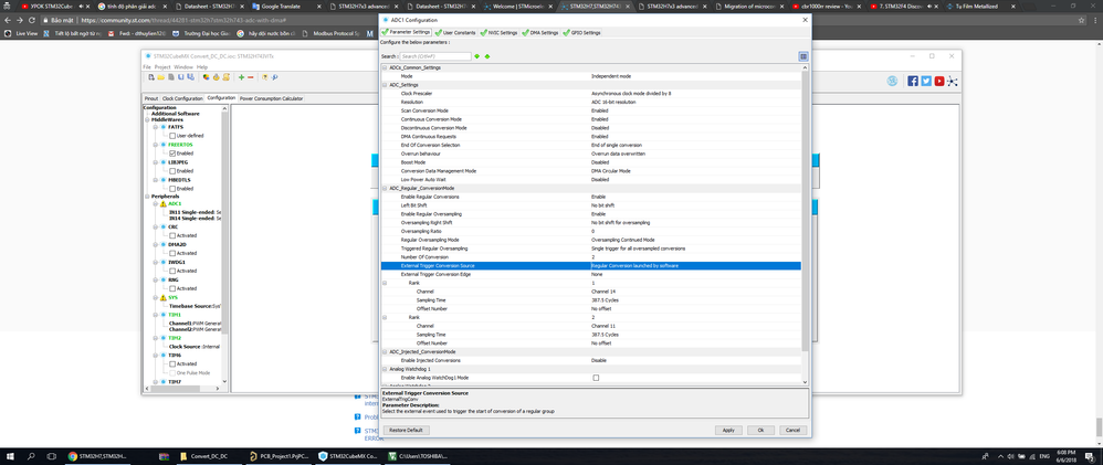

Thank for your replay. I use Keil 5 to complie, My project is read multi channels ADC, but I can't use DMA for ADC. If you know it, please help me!  I use stm32H743VI6 and variables adc_value not change...0690X0000060L9GQAU.png0690X0000060L9LQAU.png

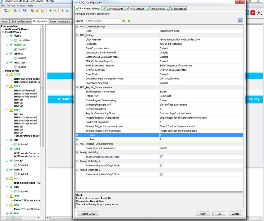

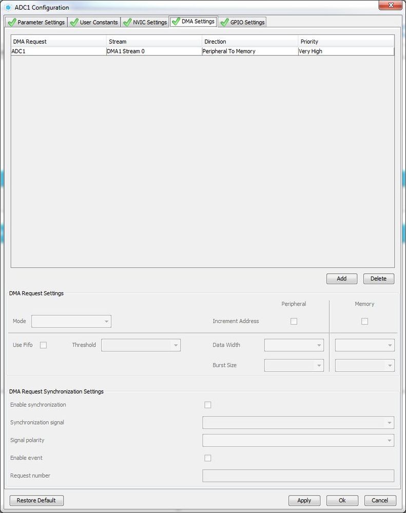

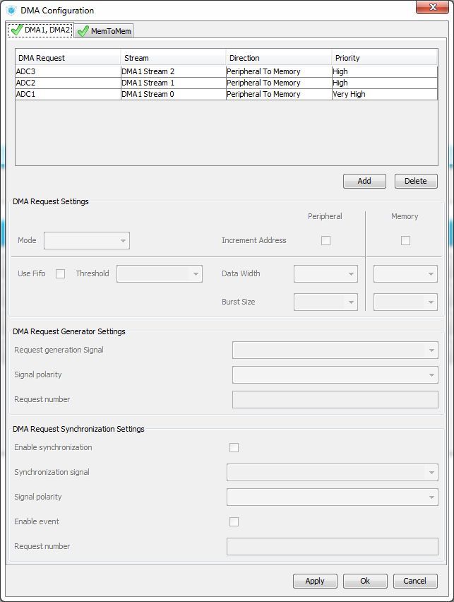

Posted on June 07, 2018 at 15:15
Hi Nhan,
My setting for ADC1, of cause I am using also ADC2 and ADC3 (looks nearly same)
Difference to your app:
ADC1 is triggered by Timer3 Capture. In your example you want to trigger by SW.
DMA definition for all ADC DMA channels
Hope this helps.
