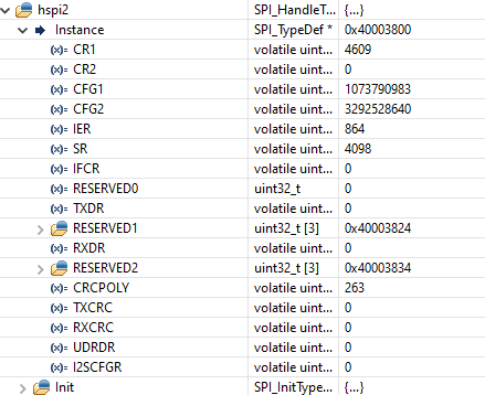

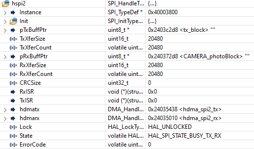

I am trying to use SPI and DMA in a STM32H7, but it is not worling. The spi handler goes to "HAL_SPI_STATE_BUSY_TX_RX" state as soon as i call the function "HAL_SPI_TransmitReceive_DMA" and it does not do anything, it does not even generate the clock signal. The CPU IChache and DCache are disabled and MPU is not used. Besides, i have placed all the memory sections in "RAM_D1" as you can see in the linker attached.
I have tried placing the DMA buffers in another memory section and place this in "RAM_D2". Besides, i have also tried aligning these buffers with "ALIGN_32BYTES", and using different DMA streams but the result is always the same.
0693W00000Ho84EQAR.png0693W00000Ho84YQAR.pngI would really appreciate any help, i am really stuck into this.

Call to transmit/receive through DMA:
uint8_t tx_block[20480+1] = {0};
void SPI_StartGetBlock(SPI_HandleTypeDef *spiHandler, char *block, uint32_t size)
	HAL_StatusTypeDef status;
	uint8_t retry;
	const uint16_t attempts = 10;
	if (size > 20480) return;
	do
		status = HAL_SPI_TransmitReceive_DMA(spiHandler, tx_block, block, size);
		retry++;
		if (retry>attempts) {
			return;
	} while (status!=HAL_OK);
	return;
Buffer where RX info would be stored, defined as global:
uint8_t CAMERA_photoBlock[CAMERA_MODEL_PHOTO_BLOCK_SIZE];
