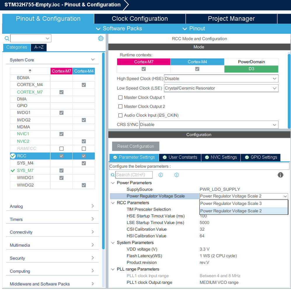

Hi, I also run into this problem. After I create a empty project for STM32H55, I don't see the VOS0 or VOS1 even though I am using PWR_LDO_SUPPLY and revision V. What am I missing here?

It wasn't that. It was the wrong temperature range device selected. As near as I can tell, CubeMX doesn't display, anywhere, the temperature range of the device that you initially selected, but it does remember it in the IOC file, and blocks off those two VOS settings.
As VOS0 and VOS1 are not valid at the extended temperature ranges, it seems that if you picked the extended temp range device, MX blocks you from picking them entirely.
I'd rather it posted a warning or something, but at least it's easy to fix.
Editing the file in a text editor to move it from a "3" to a "6" device fixes the issue.
‎2023-06-05 10:21 PM
Thank you for the reply, it works now. It turns out that even though I select the MCU with 6 suffix when creating project, the generated ioc still has the 3 suffix one.
