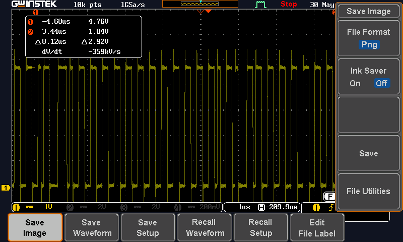

I'm using an STM32F446RE to receive data via SPDIF. This works well with the following initialisation:

Within my recvBuffer I can see the received audio data in the upper 20 bits and the flags/auxiliary bits in the lower 12 bits of the 32bit received data.
But when the incoming data except the Valid-bit all are 0 (means the device on the other end has 0 at Aux, Data and the flags except "Valid"), the interrupt never happens. The preamble of course is still valid, so that proper frames can be detected:
So shouldn't this also cause an interrupt to occur when there are enough SPDIF-frames detected? Or is there something special needed in order to receive such 0-data-frames too?

From SPDIF-frame's point of view it should be fine, there are valid preambles, the "valid"- and the "parity"-bits are set properly. Just the payload is completely at 0 (including user-, control-bit, data and auxiliary).

What is your SPDIF source?
I use the SAI SPDIF TX a lot for testing, which is working very reliably, you might try that as a source.
It might be that an idle SPDIF source is sending always zeros, just to let the receiver keep the sync. So maybe there is some setting / bit register on the STM's RX side how to react to an ongoing zero-only input?
