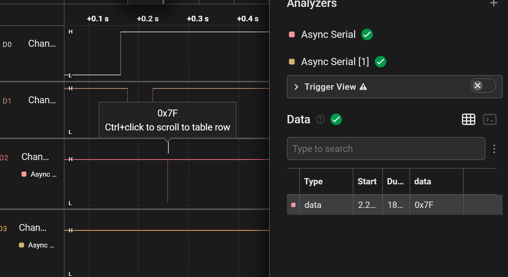

I am attaching a screenshot from a logic analyzer, the first signal is pin BOOT0, the second is RESET, the third and fourth are USART

Try waiting longer between NRST high and sending 0x7F.

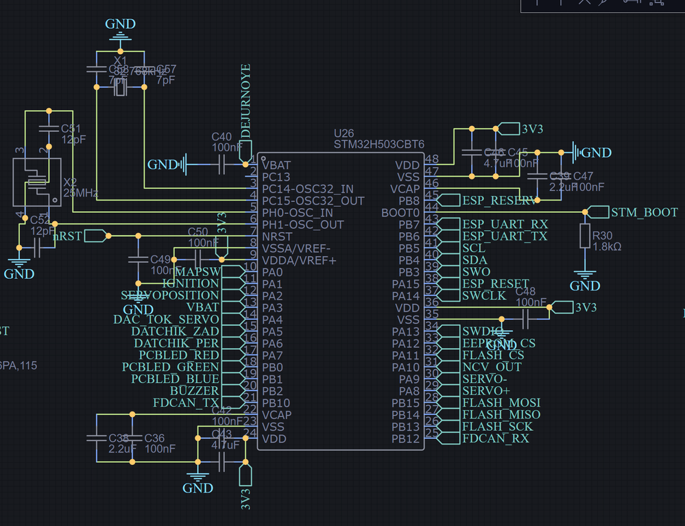

Show your FULL wiring, or schematic around the H503 ?
It won't work if the part isn't viable. So look at power supply connections, main supply, analogue.
Check state of NRST pin
Check voltage on VCAP pins is present
Check other pins described in AN2606 as possible noise sources, Especially UART RX inputs like GPS/GNSS that might chirp at start-up. The detection methods in the System Loader are one-shot, so if it's picking up noise you'll have to reset and start-over. You need to suppress other noise sources.
It might take a while for the System Loader to start completely, ie bring up clocks and PLL. Give it several hundred milliseconds
The 0x7F pattern is at 8E1, a TIM is being used to measure the pattern as a means to auto-baud
