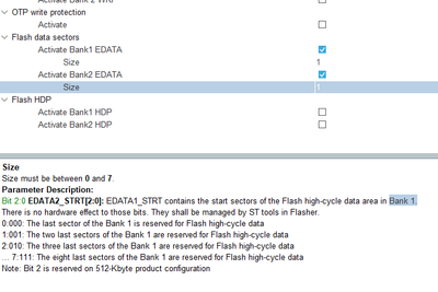

I intend to migrate an LPC development to the new stm32h5 family, I find the versatility that its flash offers very interesting. Being able to separate a set of memory into two blocks to run the main program without the need for an IAP firmware. but I have doubts.
In my old LPC I had an EEPROM memory clearly separated from the memory block. In the new stm32h5 there is talk of a high-cycling Flash capability that can function as a kind of EEPROM. My question is, can I dedicate the bank 1 portion of the Flash to EEPROM emulation and still maintain the ability to swap between banks for software updates?

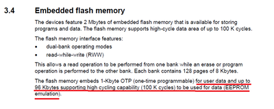

Yes - but don't dedicate 'a' bank for EEPROM_Emul.  Use both whereby each bank opposite to the operating bank is used for EEPROM emulation (RWW capability).
I have bank switching working working for fw updates + emulated eeprom for NV parameter storage using the Nucleo-H563.  My PC FOTA app transfers the new fw image to the massive SRAM3 region using TCP, validates the image, programs the inactive bank, and then flips the bank (process is mediated by a ModbusTCP register).  My only concern was for the high-cycle flash bank switching - what will happen to my NV data after the switch?  Would I have to explicitly copy over my data before the swap?  Sec 7.3.10 of the RM simply states that the swap works for the high-cycle region, but I didn't quite understand what that meant.  In my tests, I can switch the banks back and forth using my Modbus reg and can see the parameter changes that I make in one bank propagate to the other - magic!

You didn't mention which H5 part number you're using.
But in the case of STM32H56x and STM32H573, there is a dedicated part from the flash which can be used for EEPROM emulation. 48KB per bank:

Thanks for your response SofLit, I am using the Nucleo-H563. Using MXCube, the detail of the description led me to confusion
