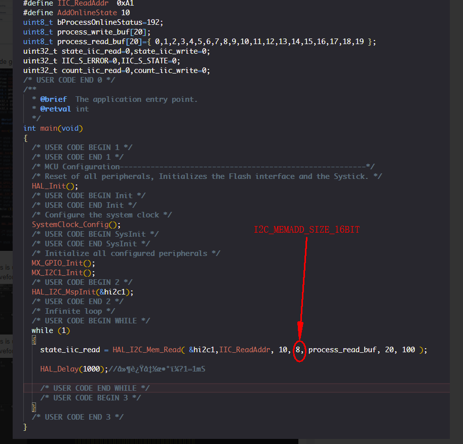

​The problem is solved
0693W00000HqBDIQA3.pngThe macro definition is wrong. After correction, the problem is solved

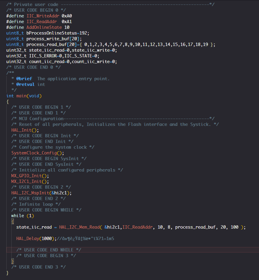

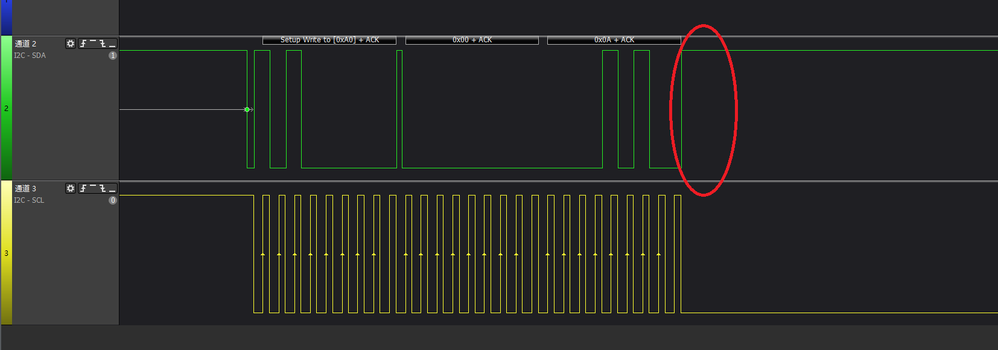

Still not enough detail. Looks like the SCL is held low. Show the full code used to produce this.

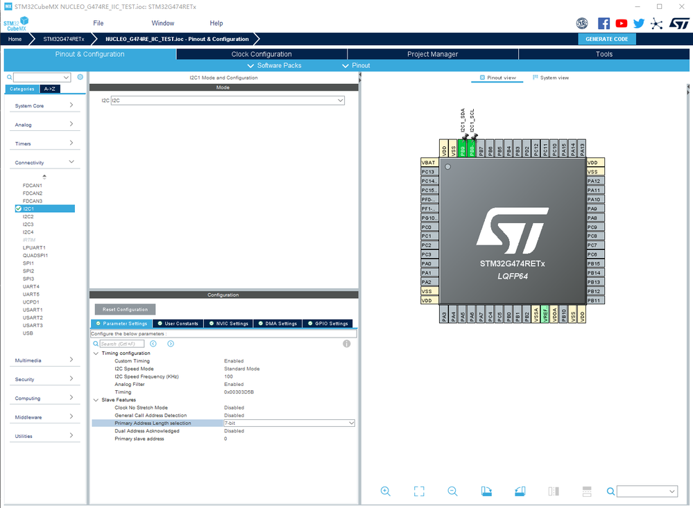

This is the cubeMX configuration

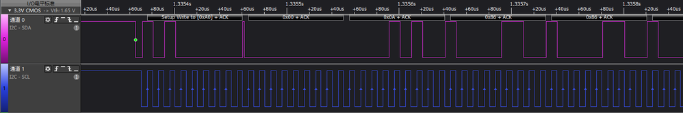

This is using NUCLEO_STM32F412RG development board, using IIC and M24C64 communication, this waveform is ok

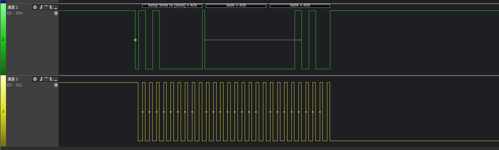

0693W00000Hq7x2QAB.pngThis is using NUCLEO_STM32G4 development board, using IIC and M24C64 communication, this waveform is abnormal
Please help analyze, is it the HAL library problem, or my problem, thank you very much for your help​
