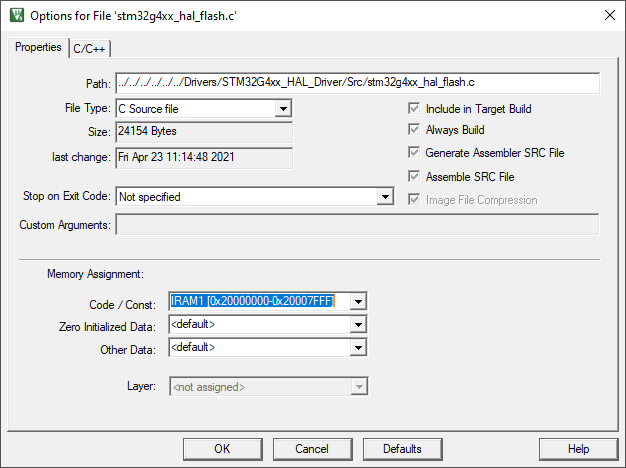

Could you please point me to a GCC example(I'm a Keil user) of how to locate my flash access functions in SRAM. My guess is that they should be located in some dedicated section, and this section should be located in SRAM.
0693W00000DldFuQAJ.pngEasiest is to open source file options using right mouse button and set SRAM as memory assignment for code. For finer adjustments you need to build your own scatter file.
J.
I guess in such a case, all interrupts have to be disabled because who knows in what memory an ISR would be located or which procedure it may call.
@JHOUD​ I also noticed that the GCC option for Keil doesn't let me easily put that file in SRAM. Did I miss something?
