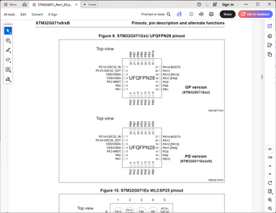

I need to confirm which version of STM32 is placed on a board. There are two versions, GP and PD. The datasheet does not really specify how the top marking is different for the two versions.
 Any ideas?

The two versions are marked as follows:
  • STM32G071GBU6 ... G071GB
  • STM32G071GBU6N ... G071BN
So, the device on your photo is a STM32G071GBU6 without N.
BTW: The marking is also shown on the packaging label.
Hope that helps?
