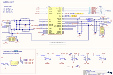

Look at STM32WBA65I-DK1 board.
STM32WBA65 features only Bluetooth Low Energy. No WIFI available.
From STM32WBA65I-DK1 board schematic:
It uses mems microphone and an audio Codec over SAI interface. Definitely you need an external codec for audio output. There is no audio codec integrated on STM32.

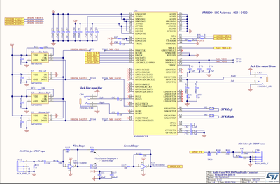

Example STM32F769. Look at the STM32F769-DISCO board schematic:
If are looking for a low cost product, make a search with STM32Finder tool or use the MCU product selector tool  and make a search of products having SAI interface and inspire from what I proposed as reference designs.
