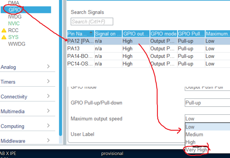

For reseting your pin you use LL_GPIO_ResetOutputPin(S2_GPIO_Port, S2_Pin);
You could do it faster by writting the corresponding bit in the BSRR register https://electronics.stackexchange.com/questions/343538/how-does-the-bsrr-register-work
I used BSRR for softwarepwm here
Also you could set the GPIO SPEED to very high
0693W00000FD8csQAD.pngI dont know how much time this will save you....
