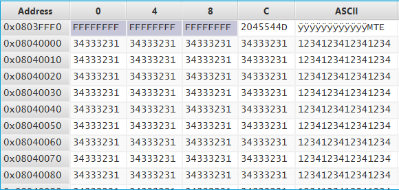

Memory content before erase operation :

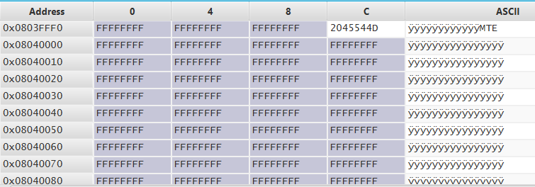

0693W00000NrCuTQAV.pngMemory after erase operation:

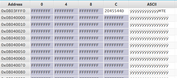

Immediatly after, I try to program in fast mode in first erased page :
HAL_FLASH_Unlock();
HAL_FLASH_Program(FLASH_TYPEPROGRAM_FAST, 0x08040000, (uint32_t)&buff_test)
HAL_FLASH_Lock();
�?��? This does not work. It return HAL_ERROR and set pFlash.ErrorCode = 0x2A0 : (FASTERR | PGSERR | PGAERR).
Memory content after programming first erased page :

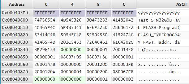

However if I try to program in fast mode the last erased page.
HAL_FLASH_Unlock();
HAL_FLASH_Program(FLASH_TYPEPROGRAM_FAST, 0x08040800, (uint32_t)&buff_test)
HAL_FLASH_Lock();
✔�? It's work !
Memory content after programming last erased page :
�?�? Could you please help to know why programming fast in NON last erased page doesn't work ?
