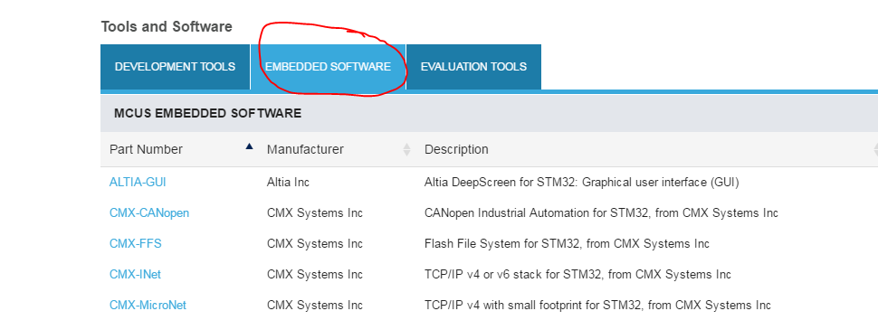

Hi
Waclawek.Jan
,The
AN4667 application note is part of
software expansion for STM32Cube, so you find it under
Tools and Software > EMBEDDED SOFTWAREof
F7xx pages:
-Nesrine-
