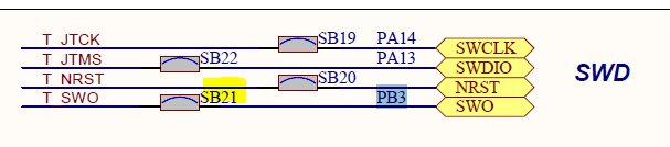

Check if there is any solder-bridge configuration on the board impacting the connectivity of PB3 (SWO) to the ST-LINK portion of the board.

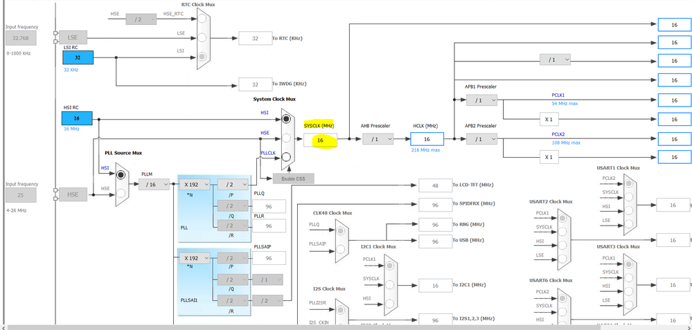

Check that the core is actually running at 216 MHz.

Posted on February 22, 2017 at 07:38
Hello Clive,
Thanks for replying. I looked at the schematics and PB3 is connected to SB21. I believe that SB21 connection is already soldered isn't it?
I checked the clock configuration in cubeMX and it is as follows. I tried setting the System clock to 16 MHz and added these lines in __write() function.
volatile uint32_t *ITM_LAR = (volatile uint32_t *)0xE0000FB0; // ITM->LAR
*ITM_LAR = 0xC5ACCE55; // Enable Access
Still I didn't see cannot see any output. I am not sure how you got to these 2 lines above?
