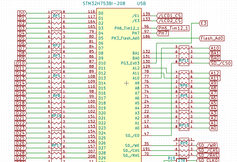

Hello, I have a PCB with LCD, SD-Ram, QSPI, CAN bus, SD card and everything works fine.
I use a STM32F769Bi (208pins LQFP).
Now I think the temp of the STM32F7 is very high (80-85deg).
Normally I work with Stm32f103 and have no temp problems.
(practically no temperature increase).
Does anyone have experience how much temperature is ok or do I have a PCB problem?

That  behavior is not normal and you should have an issue somewhere. Having a temp offset of 50 between TC ( case) @82 and 32@ board .  That means more than 1W of PD ( Power dissipation) which is exceeding 1053mW of our LQFP208 package !  Please check your PCB , software configuration of I/Os , short cuts. Etc.

probably short cuts of output pin

Of course its going to get hot.
with LCD and SDRAM, you are pounding the bus matrices.
is it your custom board ?
easy fix use a heatsink, biggest possible within the package
The proper fix is inline resistors on every high frequency line:
      data/address lines and Qspi lines ( nSS not needed)
      LCD too maybe... definately the LCD clock pin
I use 27R or 33R, upto 100R should be ok.
These are 4x33R packs. like this one
https://www.digikey.com/product-detail/en/rohm-semiconductor/MNR04MRAPJ300/RHM1349TR-ND/4083230
The advice is to place the resistor as far away from the processor as possible.
