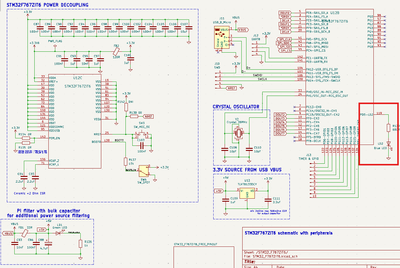

‎2024-10-11 1:10 PM
Yeah, sorry not familiar with your board design, attach schematic or portion thereof
HSE_VALUE established correctly?
PLL working? Skip SystemClock_Config() let it run from HSI
LED to VCC or GND?
VCAP capacitors present and correct? See 1.25V there?

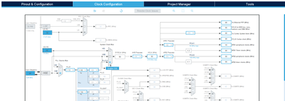

‎2024-10-14 4:03 AM
Sorry, below is my schematic for stm32. I marked LED that I was talking about with a red box.
This is my clock config. I tried using HSI and result is the same.
I cannot check at the moment if there is 1.25V on VCAP but they are present on the board.

‎2024-10-14 6:19 AM
Not sure why one ST-LINK would work vs another. Is your board self powered, or from the ST-LINK?
Nothing immediately jumping out from the schematic as problematic
‎2024-10-14 9:07 AM
My board is powered by USBs +5V line and then LDO convert it to +3.3V. +3.3V line that is connected to ST-LINK is only a reference value for ST-LINK to work properly. When I try to program my mcu the USB is also connected as well as ST-LINK.
