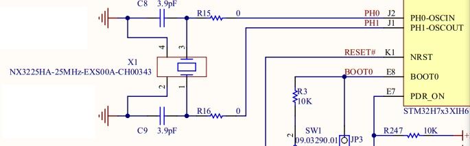

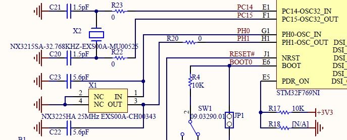

They have moved schematics to .ZIP files, Google the boards, go to the Documentation tab for the product, and pull the BOM and Schematics from there.
F769/F779I-EVAL
0693W000005D0W3QAK.jpgH743I-EVAL

Hello, i removed the R2 nd then place 1pf cap as load and now it is working..... one another weird stuff i found is that even if i remove the caps the hse is working and usb is also working.. is there a way or flag that i can check if the hse is used instead of hsi ???
For a 9 pF load crystal the correct capacitor values should be somewhere in the 8-12 pF range. If that doesn't work for you, the following (said by Clive) should be the case:
With 4 pins you need to insure you've connected the right two, and not mirrored/transposed them. If the circuit is otherwise electrically sound my concern is that you have close to 3x the required capacitance.
