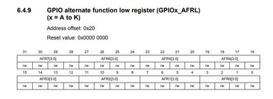

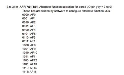

Hello @StanJerm ,
When you refer to RM0385 as already mentioned by @Issamos , the configuration of alternative function of PB2, PB6, PF6, PF7, PF7 and PF8 are made in GPIOx_AFRL (GPIOx->AFR[0])  and in GPIOx_AFRH (GPIOx->AFR[1]).
In this case:
-GPIOB configuration is done by:
  • GPIOB->AFR[0] = 0x0A000900; is used to configure PB2 and PB6 to QSPI alternate function AF9 and AF10 respectively as shown in the below table:

-GPIOF configuration is done by:
  • GPIOF->AFR[0] |= 0x99000000; is used to configure PF6 and PF7 to QSPI alternate function AF9 as shown in the below table:

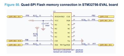

Hello @StanJerm
The board and the quad-spi flash memory are connected like this:
Then we have to programme every pin to the alternate function that it should be using. Taking a look to the DocID027589 Rev 4 (datasheet of the STM32F756) we find out that PB2, PF6 and PF7 should be configured to AF9 and PB6, PF8 and PF9 should be configured to AF10. Then and using the GPIO alternate function low register (GPIOx_AFRL) and GPIO alternate function high register (GPIOx_AFRH) we have to do this configuration. Wish is the same as the Alternate function configuration in the AN4760. ( have a look at RM0385)
 best regards.
