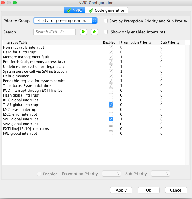

- Timer 3 channel 1 in output compare timing mode, with interrupt priority level 0

The SPI interrupt is a lower priority, so shouldn't affect it, but I've tried disabling it anyway, and that didn't help. No other timers or timer channels are enabled, so it should only be TIM3 channel 1 triggering this interrupt.

‎2017-07-21 5:32 AM
Hey, thanks for the reply.
Good thinking - I just tried setting every other interrupt I can to a lower priority, and I get the same result.
