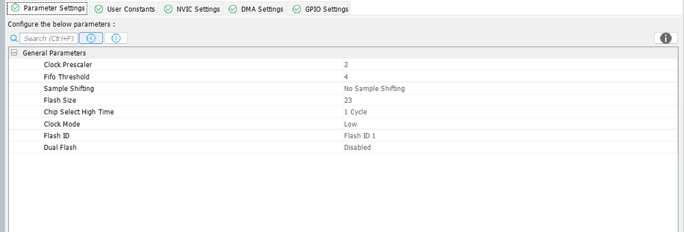

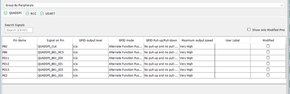

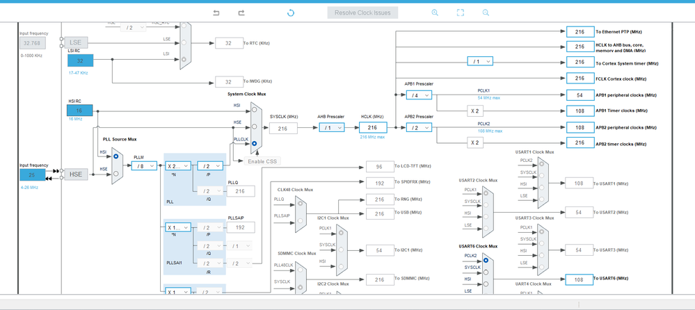

I’m currently working with the STM32F746NGH6 Discovery Kit and trying to interface it with the MT25QL128 NOR Flash via the QUADSPI interface, with the goal of creating an external flash loader.
I’m using the official STMicroelectronics driver from GitHub:  https://github.com/STMicroelectronics/stm32-external-loader/tree/896df94da5fa6dc3532d302c8f942f40bdb22bd1/QSPI_Drivers/MT25QL128AMT25QL128A QSPI Driver – ST GitHub
I’ve tried using this code  without any changes.
When I run my project, the CSP_QUADSPI_Init() function always returns HAL_ERROR.
As a result, the flash operations like erase, write, and memory-mapped access do not execute.
I’ve confirmed this by adding debug messages through UART – the initialization fails right at the start.

  • Has anyone successfully used the MT25QL128 with the STM32F746 Discovery board
  • Are there any known issues or adjustments needed when using the GitHub reference driver?
  • Could this be related to QSPI timing or clock configuration?
  • Is an explicit command like enter quad mode required before initialization?
I'd really appreciate any pointers or suggestions from those who’ve worked with similar setups.
