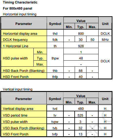

Timing LCD TFT 7 inch from datasheet:
/external-link.jspa?url=http%3A%2F%2Fwww.buydisplay.com%2Fdownload%2Fic%2FOTA7001A.pdf

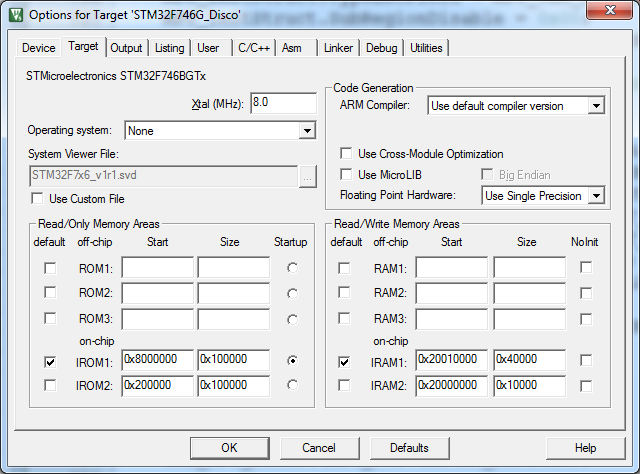

Beside, I want ask about FPU.
How to enable to use FPU in STM32F746BGT6?
How is configure FPU accuracy and MCU can run faster?

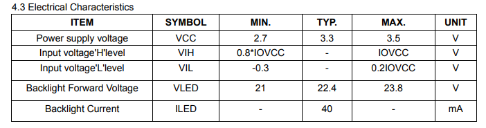

https://www.buydisplay.com/default/7-tft-lcd-touch-screen-display-module-800x480-for-mp4-gps-tablet-pc
Page 8/19:
I measure VLED is: 19.2V < VLED min = 21V.
However, LCD TFT haven't any
flicker if I don't use bus data SDRAM by other device.
When LCD TFT have flicker (other device use bus data SDRAM), VLED = 19.2V is not drooping.
So, i think ''
power supply'' is not cause.
Posted on April 04, 2018 at 10:01
I use offchip LCD drivers for this very reason, but there are a few things you can check
I think any onboard Flash access should be cacheable, its much faster that way.
can you use a low priority DMA for the flash read ?
and high priority DMA for the LCD. ??
Did you configure the SDRam for Burst mode ? is there an option for that ?
increase the front porch and back porch as much as you can, see if that helps.
Which toolchain you are using ?
Some IDEs automatically add the appropriate code if you select 'use FPU' during project creation.
How is configure FPU accuracy ...
Single precision (float), not configurable.
... and MCU can run faster?
Proper core clock and Flash settings, and enabling caches.
Posted on April 04, 2018 at 10:24
Thanks
meyer.frank
Toolol chain: MDK-ARM standard version 5.
I enabled FPU:
