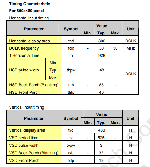

Timing LCD TFT 7 inch from datasheet:
/external-link.jspa?url=http%3A%2F%2Fwww.buydisplay.com%2Fdownload%2Fic%2FOTA7001A.pdf

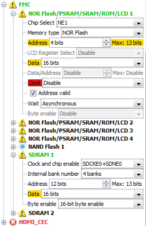

While I'm getting data in norflash, LCD have prolems is flickering.
I know that LTDC will gennerate data to LCD automatically after SDRAM refresh, isn't it?
What is solution to hold data on LTDC while other device use bus data of SDRAM (16 bit data)?
Can you tell me solutions to fix that bug, please?

Dear
Marsh.Nick
About ''increase the front porch and back porch as much as you can, see if that helps.''
http://www.buydisplay.com/download/ic/OTA7001A.pdf
option 1:
//#define LCD_7_HSYNC ((uint16_t)120) /* Horizontal synchronization */
//#define
LCD_7
_HBP ((uint16_t)88) /* Horizontal back porch */
//#define
LCD_7
_HFP ((uint16_t)40) /* Horizontal front porch */
//#define
LCD_7
_VSYNC ((uint16_t)50) /* Vertical synchronization */
//#define
LCD_7
_VBP ((uint16_t)32) /* Vertical back porch */
//#define
LCD_7
_VFP ((uint16_t)13) /* Vertical front porch */
option 2:
I'm doing.
I'll tell you about results.
Thank you.
Posted on April 04, 2018 at 13:10
Dear
Marsh.Nick
option 2:
//#define LCD_7_HSYNC ((uint16_t)240) /* Horizontal synchronization */
//#define
LCD_7
_HBP ((uint16_t)176) /* Horizontal back porch */
//#define
LCD_7
_HFP ((uint16_t)80) /* Horizontal front porch */
//#define
LCD_7
//#define
LCD_7
_VBP ((uint16_t)64) /* Vertical back porch */
//#define
LCD_7
_VFP ((uint16_t)26) /* Vertical front porch */
Flicker on LCD seems to reduce.

To stop the tearing you will have to adjust the DMA priorities, I would think.
and the bandwidth, hence the question about Sdram being in burst mode.
and making the Flash access low priority and cacheable.
otherwise as suggested,
you may need to upgrade the processor ( that sounds like Bill)
to the new STM32H743, 400MHz
can decode and display 4 MPeg4 channels at 25fps..
at 1% cpu usage.

Hi..as per my knowledge you should disable the FMC bank1 if not used, and configure correctly the MPU for the SDRAM.
Please have a look to the AN4861 application note and  disable FMC bank1 if not used and configure the memory protection unit.

Posted on April 05, 2018 at 12:33
Hi. I has same problem,also use that memory. In my opinion, the reason was a small data bus wight. STemWin library need external buffer for multibufer operation. I could be wrong, library first make picture in buffer, then copy buffer from one region from external memory to other, then that data through dma read to display. And if you store picture in nor flash, you need to read data through same bus, then that data store in temporary buffer, then copied to LTDC buffer and then read to display. And all of this in one 16 bit data line. Try to change SDRAM to 32bit wight data. I use MT48LC4M32B2P , 16 MB enough for LTDC buffer, 2 additional buffers for emWin multibuffer support and you could assign some memory for emWin heap.
pData=(uint32_t*)0xC0E00000;
GUI_ALLOC_AssignMemory(
pData
, GUI_NUMBYTES);
Also, I think u could change memory from fmc interface to double data rate quad-spi. It can be mapped to memory, but only for reading. Now I using 1024*600 display and its not flicker. The only disandvantage, draw process in freertos take 86% of mcu time.

Currently in my project:
SDRAMusing bank 5 (0xC0000000).
Norflash using bank 1 (0x60000000).
I'll try to change bank 1 to other bank.After that, disable bank 1.
Posted on April 06, 2018 at 11:42
Dear
coradias
DAHMEN.IMEN
, and every body,
Currently, i can't disable bank 1, because hardware circuit.
So, my project using bank 1 (0x60000000 - 0x63FFFFFF).
Bank sdram 1 (bank 5): ) 0xC0000000.
I think i have to change circuit for my project or
upgrade the processor to the new STM32H743, 400MHz.
Have you any other advise for me?
Thank you so much!
