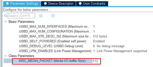

I enabled ICache and DCache, Heap Size=  0x2000, Stack Size= 2000, MSC_MEDIA_PACKET= 512.

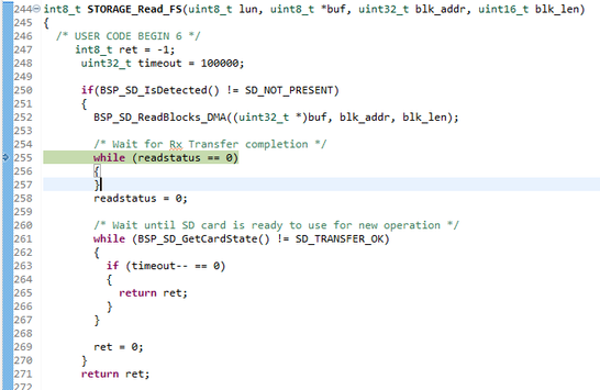

While debugging, I noticed that there were no interrupts, and the program was hanging in a loop, as shown in the picture below.
Then I commented out the while loop and the interrupts started working. I was able to read and write data to the uSD Card. I can't understand the reason for this behavior of the program. Please tell me what am I doing wrong?

I disabled ICache and DCache, but the behavior is the same. In the MSC USB device example for STM32F746G DISCOVERY I found the following information:
@Note If the user code size exceeds the DTCM-RAM size or starts from internal cacheable memories (SRAM1 and SRAM2),that is shared between several processors,
     then it is highly recommended to enable the CPU cache and maintain its coherence at application level.
      The address and the size of cacheable buffers (shared between CPU and other masters) must be properly updated to be aligned to cache line size (32 bytes).
My user code size is only 19,54KB and it is completely in DTCM-RAM. Please see on the picture below.

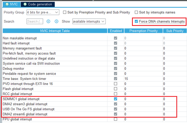

I have completed all the settings in CubeMX. The table below shows the interrupt priorities.
Please tell me how to correctly set interrupt priorities?

Code is far from ideal
Needs better timeout and bounding conditions.
The second loop needs to be bounded by TIME, not ITERATIONs
Likely seeing cascading failure, where the prior command didn't complete properly, so the next doesn't start nor interrupt.
The coherency issues on the F7 can be entirely avoided if the DMA buffers live in DTCM-RAM, the code doesn't need to be there.
I'd bound the first loop by TIME to, and fail with an error, not just stop and die there.. Removing it solves no problems.

When MSC_MEDIA_PACKET = 512 all works good. But when I set this parameter to 1024, disk works is not correct.
The drive appears fine in Device Manager, but when I try to open it, Windows prompts me to format it.
Formatting cannot be performed, an error occurs.
I increased the heap and stack size to 0x10000, but that didn't solve the problem.
