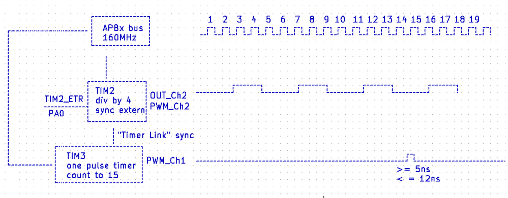

i have to design a board, where a STM32F746 must read a 16 bit/40MSample ADC, into internal or external (SD)RAM. The ADC data bus will be 32 bit wide with 20MHz clock. The memory interface is an other problem, but i have to generate 3 different trigger signal for the ADC (it is 1 trigger signal, for 3 different configurations, to read 1, 2 or 3 channels). I have attached the timing diagram from the ADC datasheet.
My problem is now the question: can the trigger signal be generated by the STM32F746 timers, or do i need external logic to generate them. If possible, i would prefer the STM32F746 internal timer, to save board space and cost. Further would it be great if the sync-to-external-ref-clock feature of the STM32 timer could be used. After reading the STM32F746 datasheet and the 'STM32 timer cookbook', i think the following setup should work(ADC_triggerGen_STM32F746_3ch.png):
- APB1/2 bus setup for 200MHz
- TIM2 with the ETR2(sync in) and OUT_CH2(or PWM_CH2) as MCLK for the ADC
- --- TIM2 should divide the APBx frequency divide by 5 to output 40MHz
- Ether TIM6,7,8,10,11 or 13 to count to 13(8,5) to generate the signal for the 3 channel(2 channel, 1 channel) trigger
- TIM1 configured as one pulse timer, triggered by the above TIM(6,7,8,10,11 or 13) and ouput on PWM_CH1.This one pulse generator is needed to create the trigger pulse according the timing diagram of the ADC, it must be min. 5ns and max. 12.5ns.
- 3 hardware pins used (ETR2, OUT_CH2, PWM_CH1)
This setup should work just in hardware, without CPU load if possible (except the setup and switching between 1channel, 2 channel or 3 channel mode).

' What you mean with 'two timing parameters'? You mean the TIM2 for the 40MHz MCLK is possible, but the TIM6 + TIM1 combo for the trigger pulse not?Maybe my writing was a bit confusing, because i asked for all 3 modes i like to implement. To make it easier to understand, let me just ask for the 3 channel mode, what is the most needed.
- TIM2 with the OUT_CH2(or PWM_CH2) as MCLK output for the ADC
- --- TIM2 should divide the APBx frequency divide by 5 to output 40MHz ADC-MCLK
- TIM6 (feed by 200MHz APBx) to count to 13 to generate the signal for TIM1
- TIM1 configured as one pulse timer, triggered by the above TIM6 and output on PWM_CH1(=ADC-TRIGGER). This one pulse generator is needed to create the trigger pulse according the timing diagram of the ADC, it must be min. 5ns and max. 12.5ns.
Can ADC-MCLK be generated by TIM2? Can ADC-TRIGGER be generated by TIM6+TIM1?

- you can't divide by 5 'symmetrically' - the best you can achieve is 2:3 duty - your decision if this is OK
- you don't need additional timer to count pulses for the second waveform - one timer is enough, simply change its period
- what's the purpose of 'ETR2(sync in)'?
‎2018-06-12 7:43 AM
- you can't divide by 5 ''symmetrically'' - now where you say it, i see it as well. I thought, i can use a PWM timer setup with 50% duty cycle, but there are not enough clock cycles for a 50% duty PWM. Using 160MHz APB1 and divide by 4 to get the 40 MHz should be ok?
- what's the purpose of ''ETR2(sync in)''? I would like to be able to synchronize the ADC trigger to an external reference signal. As outlined in AN4776 ''STM32 timer cookbook'', chapter ''Timer clocking using external clock-source''. For now, i only ensure the pin (PA0 - TIM2_ETR) is brought out on the PCB.
I have updated the clock tree to 160MHz div 4:
Will it wok this way?
‎2018-06-12 11:07 AM
- you can't divide by 5 'symmetrically' - now where you say it, i see it as well. I thought, i can use a PWM timer setup with 50% duty cycle, but there are not enough clock cycles for a 50% duty PWM. Using 160MHz APB1 and divide by 4 to get the 40 MHz should be ok?
In fact, the assymetric waveform, while not typical, in most of the cases is OK too - that would require to be verified in the ADC's DS.

thanks for your fast response and the patience to answer my questions. After seeing the limitations, i will go the route with an FPGA. The hint with the DCMI was good, but actually not within my requirements.
I am quite happy with the fast response in this forum, and the qualified answers. You saved me from a mis-concept.
