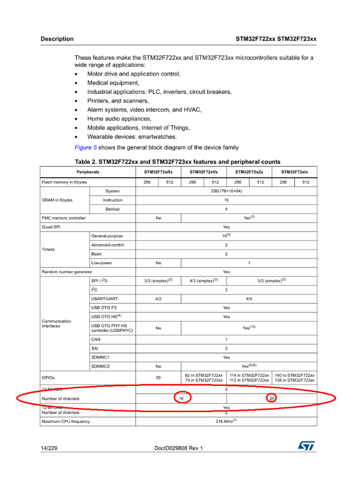

I am trying to map my pins to use all 16 channels from each of the 3 ADCs,  but it seems like I am unable to do it because not all of the ADCs channels have their own pins.  Is there a way to do this?

No.
