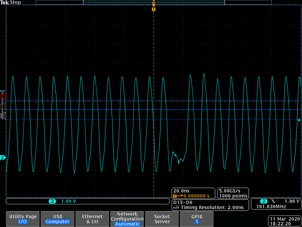

0693W000000ThZgQAK.pngWith a long row of similar commands in the while loop like
void RAMFUNC FastToggle(void)
    GpioPinConfigSet(NUTGPIO_PORTB, 10, GPIO_CFG_OUTPUT |GPIO_CFG_SPEED_HIGH);
    volatile uint32_t *gpiob_bsrr = &GPIOB->BSRR;
    uint32_t on = (1 << 10);
    uint32_t off = (1 << ( 16 + 10));
    while(1) {
        *gpiob_bsrr = on;
        *gpiob_bsrr = off;
        *gpiob_bsrr = on;
        *gpiob_bsrr = off;
I get following scope picture. The one prolonges cycle is when the while loop jumps back:
Running at 216 MHz I get about 202 MHz change rate at the GPIO.
