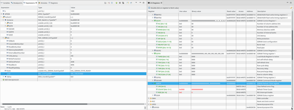

So, first is main where CubeMX's configs are run first and after that SDRAM_Init function. There is also couple of debug flags there. I am not able to get anything reacting with current code. With ST-Links I can see that SdramTiming values do change in hsdram1 expression, but when I examine SDRAM1 control and timing registers there is nothing (all zeroes). Seems like that the whole pheriable is not responding (incorrect clock config? Clock config is made by CubeMX). What am I missing?
As an attachment there are couple of screenshots from debugger, from variables that do change and registers that stay 0
Sorry for broken English

Thank you a lot guys. Couple of days I have tried to solve problem. Here where I am standing now:0690X00000609o9QAA.png
Solved compiler warnings and cleaned up code but thats about it. I already had that BSP_SDRAM_Initialization function, but only named SDRAM_Init. I did play around it's placement, when to run it. Changing position to the end of Cube's SDRAM procedure as Sree suggested did not change a thing. (It should not matter if function is run from Main or from Cube's init function?) I can still see good values at Expressions, but on registers there is nothing. I did study that example and that rised some good questions:

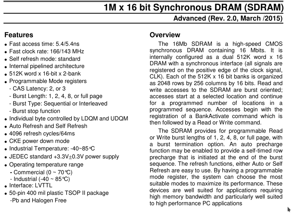

Posted on February 23, 2018 at 19:12
How exactly is this wired up?
hsdram1.Init.ColumnBitsNumber = FMC_SDRAM_COLUMN_BITS_NUM_8;
hsdram1.Init.RowBitsNumber = FMC_SDRAM_ROW_BITS_NUM_12; // Isn't it 11
hsdram1.Init.MemoryDataWidth = FMC_SDRAM_MEM_BUS_WIDTH_8; // Isn't it 16
hsdram1.Init.InternalBankNumber = FMC_SDRAM_INTERN_BANKS_NUM_2;
A10 is a bank switch
https://community.st.com/external-link.jspa?url=https%3A%2F%2Fwww.alliancememory.com%2Fwp-content%2Fuploads%2Fpdf%2Fdram%2F16M-AS4C1M16S-C%26I_v2.0_March%25202015.pdf
Posted on February 23, 2018 at 20:11
Oh yes, I had old configs left there, my bad to cause confusion. I have been testing different things with CubeMX and forgot to reconfig everything back as they were. Yes, A0:10 and A11 as bank switch, D0:15 and L/UDQM enabled. Heres is PDF of schematics:
https://www.dropbox.com/s/r8hi3rfyiaxumij/FSO_mittaristo_v2.pdf?dl=0
