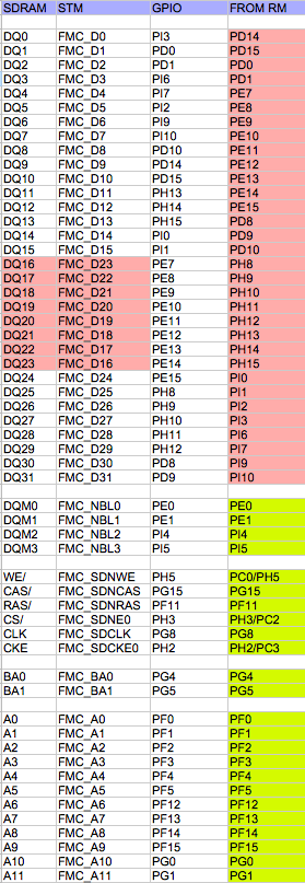

Hi Clive,
Ok I tested the DISCO code, with proper conf for my board, and the behaviour is exactly the same. It's working for 32 bit, but not for 8 bit.
I updated the schematics from my previous post with more hi-res files, sorry about that.
I noticed something when checking the pinout :
The three first columns are what I actually have wired on the PCB. You can see that the third block of eight pins (DQ16 : DQ23) are reversed.
I also noticed that none of the data pins are wired on the GPIO like indicated on the reference manual (last column).
Could it have an impact on the outcome of my read/write attempts?
Because your data bus is all muddled up. The byte positions don't match up with the signals.
Yes, going through it now, the byte positions are muddled up.
Bit reversal within the byte would be tolerable, probably, but the byte lane signals would need to map properly, and the bits here don't map well
As I see it D0..D7 on schematic map to D27, D2, D3, D28, D29, D26, D30, D31 (mix of lane 3 and lane 0)
At a bit level I think this will impact the config words written also

Lix Paulian
Senior
This is an old thread, I suspect that the issue has been solved in a way or the other. However the correct resolution can be found here:
https://www.keil.com/support/docs/3777.htm
I stumbled on this and I spent almost two days debugging this one. It is an issue with the FMC and misaligned accesses in the SDRAM area (addresses above 0xC0000000). I am adding this post here for those who may have the same problem. There is no mention on this in the STM32Fxx manual. I don't want to detail the possible solutions here (follow the link), however suffice to say that I used the MPU recommendation and it worked perfectly for me.
