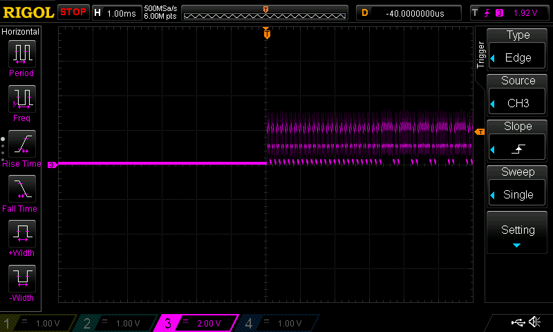

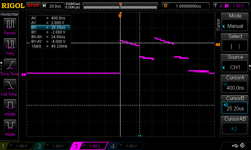

Posted on December 08, 2016 at 21:14
lampii,
How did you verify the system clock frequency? Output to MCO pin and measured with oscilloscope?
What exactly do you mean by 'data pulse' and how did you measure it?
Clive,
I don't SPL but IMO FMC_ExtendedMode_Disable means FMC_BCR.EXTMOD = 0, i.e. FMC_BWTR (the write timing) is ignored.
Posted on December 08, 2016 at 21:35
Correct, I enabled MC01 and MC02 and went through each of the clocks.
Here is a screen cap of the Oscilloscope measuring one of the data lines. Here the code is set to write 0xFFFF without delays in an infinite loop.0690X00000605oZQAQ.png0690X00000605otQAA.png

Posted on December 08, 2016 at 22:57
I will try and port the project to HAL tonight and see. Thanks for taking a look into my issue. I really appreciate it.
I posted screen captures of the oscilloscope measuring the data pin above to show what I meant.
