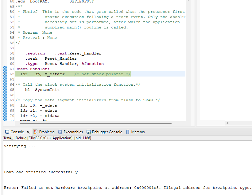

Start by dumping content in the QSPI device in the loader app, have a functional Hard Fault Handler and then try stepping across the control transfer code into the QSPI.
Can you see the memory content? Is it faulting? Is it entering the Reset_Handler code within your QSPI app?
you are not able to debug the code in the NOR flash that is because you do not have the symbol file. you can make the symbol file when you build the application code which you loaded into the NOR flash, and loaded the symbol into the project when you put the application code in NOR flash

I am also working with the QSPI in STM32, boot from External flash (N25Q128A), And while debug, code is halting in Reset handler and not going to the main() and getting error as "illegal address for breakpoint type". and if I reset board then it is giving same error and showing "could not halt device (18)". But if I press reset button on board, It is programming the board.debug issue.png
Hi I am using STM32CubeIDE, and I am also not able to debug code (Specifically NOT HALTING CODE using breakpoint when application code executed from NOR Flash). can you please tell me the process of making symbol file and how to load the symbol into the project when I put application code in NOR flash.
