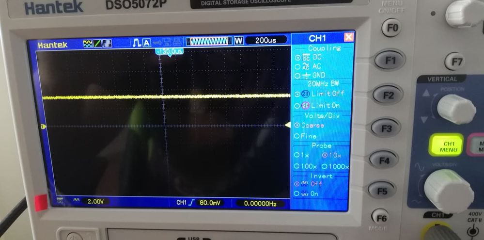

I have put an endless while loop in the code like you said. I have then sampled the pin with the probe and i get same result(a waveform with modifying frequency. I have uploaded a video showing this). I selected 'dc coupling' on the scope because i was expecting to see the waveform as a pwm output woth 16 mhz frequency. Instead when i select dc coupling i get a sognal which is around 3.24v in amplitude. About your suggestion to increase the zooming i have tried that as well but my scope does not seem to let me go further than 10 mv per div.

I have attached a photo with the channel 0 when 'Dc coupling' is selected and also all the settings are shown there on the right:
DC coupling is OK, but even with AC you should've seen something else than just noise. You should adjust the timebase to ca 100ns but again, even with 200us as you have it now you should see something.
So the MCO1 is not working, or the mcu is not running at all.
Try to write a simple program which sets a pin as GPIO Output and toggles it in a loop.
The mcu is working I have tested already. I guess if everything else was correctly done that I have done something wrong when configuring it. I will look at the documentation and try again. Thanks ;)
