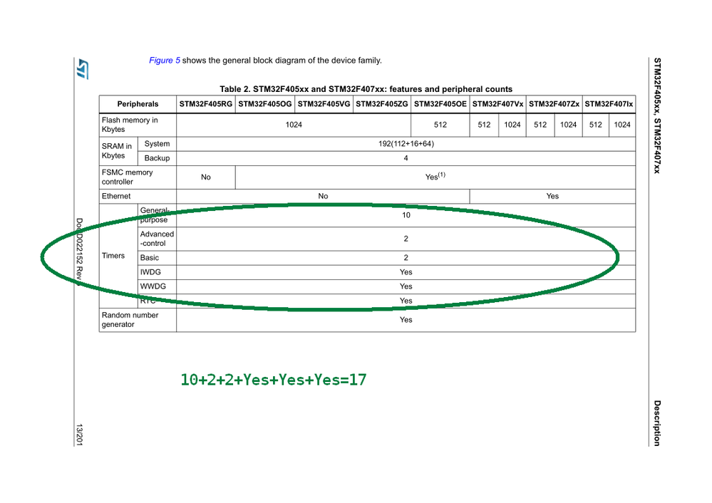

'Up to 17 timers: up to twelve 16-bit and two 32- bit timers up to 180 MHz, each with up to 4 IC/OC/PWM or pulse counter and quadrature (incremental) encoder input'
12+2 is 14, even for extremely large values of 2, and you can't count the 32-bit ones twice. And I'm pretty sure both the 32-bit timers on APB1 at 45 MHz (TIMCLK 90 MHz)
Who needs 17 timers anyway? Kind of indicative you've got some sub-par ideas about how a singular timer needs to function. How about ONE timer with 17x 32-bit comparators, or THREE with 8x?
Posted on March 30, 2017 at 22:44
They count up the RTC, and the two watchdog *timers* - said Table 6 does not show this anymore, but you can see it in other STM32 DS. Funnily, SysTick is not counted.
