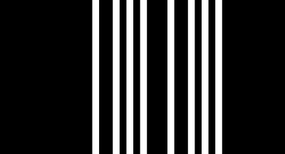

I am trying to use an RGB888 (854x480) 24bit image.
However, this image has a total size of 1.2MB and cannot be used in flash memory.
The image I use is below.
The first line of data determines all image data.

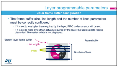

So, can the entire data be transmitted with the first (854x1) 24bit data?
Code is being written using the Standard Peripheral Library,
The code used is as follows.
This is the part where LTDC Initialize and Start of layer frame buffer are specified, as well as line length and ptich.
static uint32_t RGB888_854x1[641]=

    /* the length of one line of pixels in bytes + 3 then :
      Line Lenth = Active high width x number of bytes per pixel + 3
      Active high width         = 480
      number of bytes per pixel = 2    (pixel_format : RGB565)
      number of bytes per pixel = 3    (pixel_format : RGB888) */
    LTDC_Layer_InitStruct.LTDC_CFBLineLength = ((Active_Width * 3) + 3);
    /*  the pitch is the increment from the start of one line of pixels to the
        start of the next line in bytes, then :
        Pitch = Active high width x number of bytes per pixel     */
    LTDC_Layer_InitStruct.LTDC_CFBPitch = (Active_Width * 3);
