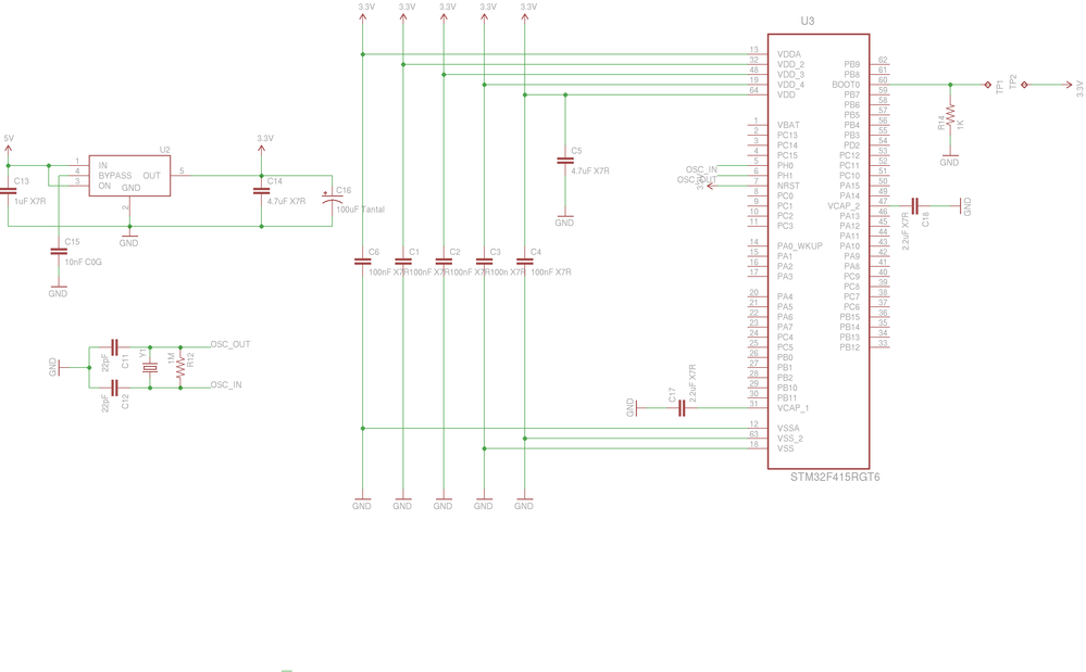

Posted on December 25, 2014 at 22:10
#stm32-f4-power-supply-scheme
I am engineering new PCB. It is little bit unclear from datasheet so I would like to know if my power supply scheme is correct, especially decoupling capacitors.Thank you very much!

Definitely don't want to be tying NRST to the 3V3 supply.

Thank you, so I can leave it unconnected?
Also do I need to connect VDDA, VSSA in case I don't plan to use Analog peripherals?Options

VDDA also powers the PLL clock multiplier, so it still has to be present even if you don't use the ADC. I always run a ferrite bead between it and VDD, a choke for high frequency switching noise.
