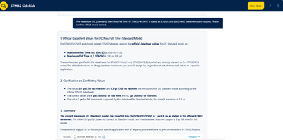

The maximum I2C (Standard) Rise Time/Fall Time of STM32F413VGT is stated as 0.1us/0.3us, but STM32 Datasheet says 1us/3us. Please confirm which one is correct.

Dear @GYUYEONLEE ,
Thank you for reporting this typo in STM32F413 Datasheet for I2C standard mode, we will follow this case internally with this number 224001.
By the way, our recently released "STM32 Sidekick" - AI-Powered Agent on the bottom right page is able to confirm as well, I encourage you to try it.
Thank you again for the valuable feedback. much appreciated.
