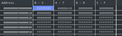

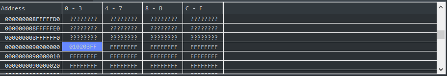

What I discovered is that when i look at the address 0x90000000 I dont always see the entire byte array i sent !
For example :
uint8_t aTxBuffer[] = {0x01,0x02,0x03,0x04,0x04,0x08,0x0A}
If I send this array, the third byte (0x03) seems to block something in the software, in fact if I read the address 0x90000000 I find that after the 0x03 no more data is sent!
But if I change that 0x03 with another byte like 0x02, so:
uint8_t aTxBuffer[] = {0x01,0x02,0x02,0x04,0x04,0x08,0x0A};
entire data is transmitted , and I can read it all!
I've set sCommand.NbData   = 40, thats why some "0" are sent too..
I dont really understand where does this issue can come from... I mean just because I change a byte transferred, the program has to not work correctly?

2) I tried to debug the Transmit phase, and i'm sure that entire byte array is transferred out
3) some other bytes are blocking (0x05,0x07,0x09, 0xAB, 0x47.......) ---> They are all ODD !

Maybe you're mixing modes: QPI mode (for most manufacturers) means that *everything* (instruction, address, data) is sent/received on 4 lines. Whereas the 4PP command (0x38) you mentioned is sort of "mixed mode" command: instruction is sent on one line only, whereas address and data follow on 4 lines. The datasheet explicitly says that 4PP is SPI-only, whereas the standard PP (0x02) command adapts itself automatically to SPI- vs. QPI-mode.
You didn't mention the WREN command, but I suppose it's issued before every programming (including the WRSR) command?
BTW Bit 6 of status register enables QPI mode, not QSPI (the latter is ST's name for the interface in the MCU).
Abrug.1
Man, many many thanks!!
I tought that QPI and QSPI were the same thing, now with the command 0x02, intruction 1line, address and data in4 lines, it works!!
