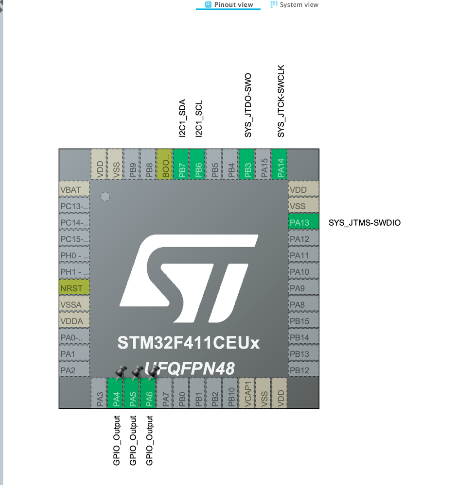

I set the SWD up for a project inculding a PCB with an F411CEU6 and an VL43L8CX. To test the pcb, I wana get the distance printed to the SWD console. I set up the SWD and with the main.c file it works fine, but with the vl53l8cx.c the printf statements don´t get printed...
Do you guys have an idea?

- The STM32F411 is on a costum PCB
- the VL53L8CX is directly soldered to the PCB
The LED from the PCB is blinking, and the programm is the first test with the new PCB, I was able to get some printf statements back from the chip -> Chip should work
Now i wanna try if the I2C Connection to the VL53L8CX is working, this is why I started this chat, because I hat problems with the debbuging / printf statements
This is the Pinnout of the StM32 chip:Screenshot 2023-12-28 at 11.53.21.png
Thanks for your patience!

Make sure you use the same voltage levels on the pins referenced to IOVDD.
According to datasheet DS14161, you must adapt the GPIO levels to 1.8V between the STM32F411 and the sensor. I hope your pcb includes a voltage level shifter?
https://www.st.com/resource/en/datasheet/vl53l8cx.pdf
I wish you all the best in your I2C communication trials, let us know if you need help.
Best regards,
Romain,
Okay thanks, I missed that’s while designing the PCB. I will redesign it and than try it again. Thanks and a have great ne year!
