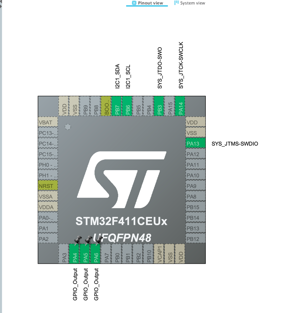

I set the SWD up for a project inculding a PCB with an F411CEU6 and an VL43L8CX. To test the pcb, I wana get the distance printed to the SWD console. I set up the SWD and with the main.c file it works fine, but with the vl53l8cx.c the printf statements don´t get printed...

Hi @julion2
SWV needs pin PB3/SWO to transfer ITM data and the CPU clock speed correctly configured in SWD console.
Check if :
- Your firmware does not change the PB3/SWO configuration when using VLX ToF by reading the GPIO register.
- Your CPU frequency speed is also the same between the SWD console and the device (STM32F411 CPU max frequency = 100MHz)
Let me know if it helps.
Regards,
Romain
Thanks, for the answer. PB3 was actullay used for an gpio output so I changed that, but still not working in the vl53l8cx.c file...
The clock frequency is the same (printf is working in main.c but not vl53l8cx.c)

This is the Pinnout:Screenshot 2023-12-28 at 11.53.21.png

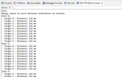

RomainR.
I tested on my side printf with SWO, first from main() and from an external function. It works in both case.
Share your project and I will check it.

Thank you for sharing ioc, main.c and your vl53l8cx.c.
First, you do not include <stdio.h>, so you need it everywhere you use stdio function like printf, putchar or getchar...
Then your main function call only printf("Test"); and never use any of the function used by vl53l8cx.c?
If you never call VL53L8CX_GetDistance() somewhere, there is no chance to print something somewhere...
I confirm the printf through SWV is working everywhere. I just written the function below outside of main.c and force some constants values because I do not have ToF sensor in my hands today.
int32_t VL53L8CX_GetDistance(VL53L8CX_Object_t *pObj, VL53L8CX_Result_t *pResult)
Check again your firmware, call vl53l8 function from main and place some breakpoint in order to debug.
