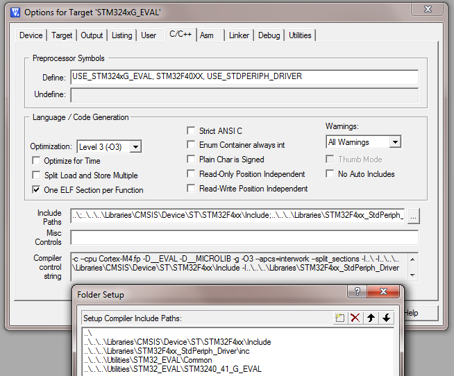

Hi, Am having this error, &sharperror ''Please select first the Evaluation board used in your application (in Project Options)'' i commented /* &sharpdefine STM32F427X */ in STM32F44XX.h but i still have this error , how can i fix it. Thanks #understand-your-tools- Mark as New
‎2013-04-15 8:58 AM
Yeah, your not defining a BOARD that's supported, look at the #ifdef stuff above the failing line.
USE_STM324xG_EVAL, STM32F40XX, USE_STDPERIPH_DRIVERUp vote any posts that you find helpful, it shows what's working..
‎2013-04-15 9:11 AM
it is resolved thank you but now i have this error :
fatal error: stm324xg_eval.h: No such file or directory- Mark as New
‎2013-04-15 9:48 AM
Ok, so you haven't correctly defined all the Include paths needed for the project (-I command line option list). You need to point into the Utilities directories containing the files the compiler needs to find.
STM32F4xx_DSP_StdPeriph_Lib_V1.1.0\Utilities\STM32_EVAL\STM3240_41_G_EVALUp vote any posts that you find helpful, it shows what's working..

You can also control the Include path search order, here is how the projects expect things to be defined. Adapt as appropriate.
