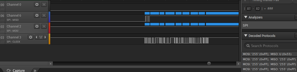

i'm using an STM32F407ZET6 with SPI1, SPI2, SP3 and SWD.
SPI1 and SPI2 are always working fine.

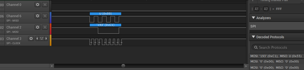

SPI3 works when the CPU is running without debugging.
Whenever I set a breakpoint SPI3 Clock (PortB3) has strange pulses.
I checked how to disable JTAG on STM32F4 in RM0090. It shoud be done automatically when
Changing the Pin Configuration:
GIO_InitStructure.GPIO_OType = GPIO_OType_PP;
GPIO_InitStructure.GPIO_PuPd = GPIO_PuPd_NOPULL;
GPIO_InitStructure.GPIO_Mode = GPIO_Mode_AF;
And changing the Alternate Function mapping:
GPIO_PinAFConfig(SCK->GetPort(), SCK->GetPinSource(), GPIO_AF_SPI3);
Both is done in my code and as SPI3 is working (logic analizer and SPI-Chip is responding) as long as I break debugging via breakpoint or halt.
However when I set a breakpoint SPI3 fails as SCK outputs something. I can also see that AFRL3 is always changed back to 0 and OSPEEDR3 is always changed back to 3.
Can anybody give me advice how to solve this issue?

    PB3 is SWO, so maybe your toolchain is trying to switch on the serial-wire-output. Read the manual to your toolchain, or browse through its settings.

    I guess you think the toolchain (IAR EWARM) is reactivating JTAG, again?
    The Datasheet for the STM32F407XX DM00037051 says:
    PA13 AF0: JTMS/SWDIO
    PA14 AF0: JTCK/SWCLK
    PA15 AF0: JTDI
    PB3 AF0: JTDO/TRACES -> would be JTAG output
    PB4 AF0: NJTRST
    I tried SEGGER J-Link and IAR I-Jet, both are configured for SWD as interface. On the microcontroller only SWDIO, SWCKL, /RESET, VCC and GND are connected to the debugging probe. So normally when the toolchain reactivates JTAG it shouldn't be able to debug as the JTAG-Pins are not connected to the probe.
