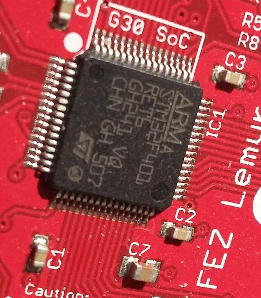

While the text is certainly a big cue, you definitely have parts where the pin 1 is less than crystal clear
Note also the round, some what indistinct round laser mark next to the ST Logo, these aren't helpful to the casual inspection

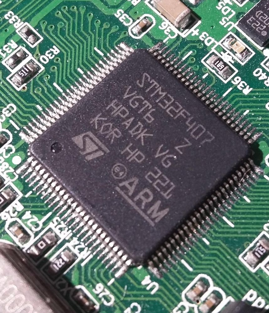

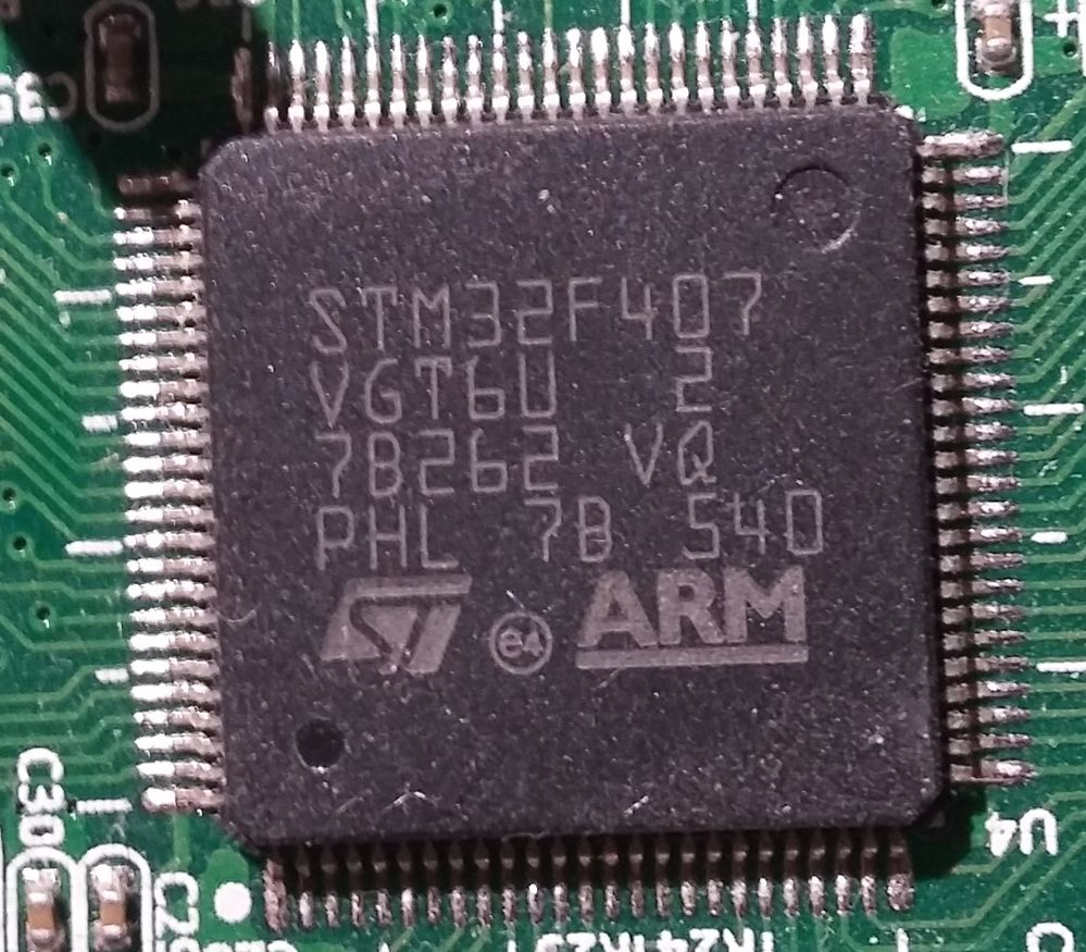

Ok, and here is the part that breaks the manual, and the one I looked at last night when responding to Andrei's question, the other F407-DISCO boards I looked at this morning lacked the ejector. As a casual observer you can see why this could be place 180 from desired.
So that's one packaged in the Philippines,
Here's one from Korea, which is orders of magnitude clearer
Apologies for all the different image orientations/angles, doing this with my cell phone, trying to get the lighting to capture the surface details, and stay in focus.

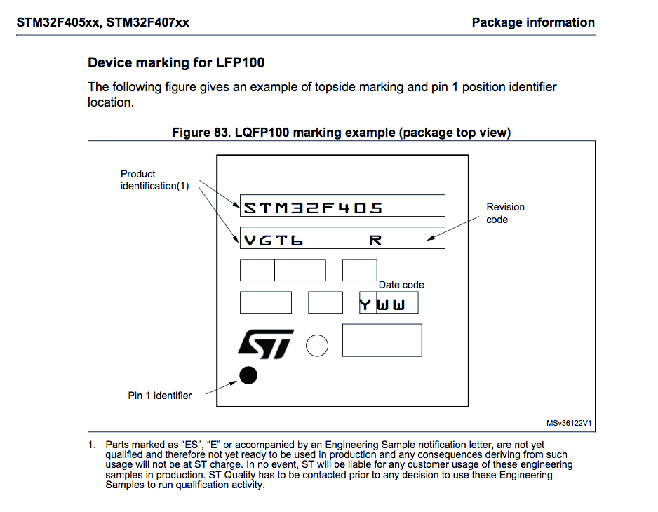

That's unpossible Clive, here is the '407 LQFP100 manual package description.
There's no mention of the ejector pin details that you show in your pictures.  (troll lol lol lol oooo)

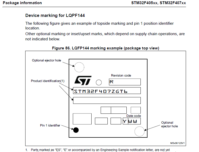

On the current STM32F407 Data Sheet    DocID022152 Rev 8       09-Sep-2016   it says above that diagram, 'The following figure gives an example of topside marking and pin 1 position identifier location. Other optional marking or inset/upset marks, which depend on supply chain operations, are not indicated below.'
On this maybe, give them a break?

I don't think any of this is meant with meanness or anger, it's just frustrating. The manual really should have a comprehensive set of examples covering the assorted supply chain and encapsulation variations, it can be a separate document for all I care. I can provide my people on the line and in the lab with an array of photos to help identify pin one, but there's no guarantee its current or has 100% coverage. I've got other 407 from China here also, and don't think I've got pictures of all the other variants to hand.
My frustration would be the counter-pointed ones, where the ejector mark is opposite and of similar depth, radius and profile, and result in 180 placement. The manual picture with two ejection points counter to each other and not opposite pin 1 perhaps less so.
Posted on July 17, 2017 at 18:05
Addendum : Having a disclaimer that basically translates to 'parts might not look like this at all' seriously devalues the document and it's fitness for purpose.
