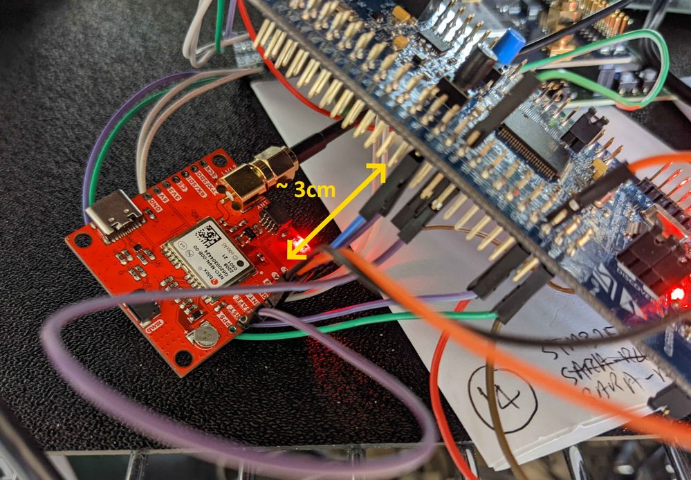

I am using an STM32F407 MCU as an I2C master, my code built on the LL API of the STM32F4Cube IDE (version 1.25.0). I find that quite often, i.e. always within a handful of bytes, the BTF flag fails to set when I am doing a multi-byte TX. Single-byte TXs always work, it is only multi-byte TXs that suffer from this problem. I do not appear to receive a NACK from the far end (i.e. I2C_FLAG_AF is not set while I'm waiting for BTF to set), just not a "set-BTF".

waclawek.jan
It's not entirely clear from your picture, but it appears that your GND comes from a different point than the Disco board. It's more important to keep ground short and perhaps give each signal its own ground, you can try to twist it around the signal wire.
3V/3.3V shouldn't be important with I2C.
I'm not entirely sure why you observe what you observe in the I2C flags, but the I2C module is prone to surprising changes in its internal state machine when the I2C signals are subject to externally induced disturbances (you can try to induce them deliberately by momentarily shorting them, it's a good exercise in handling surprises). I recommend using timeouts throughout and recovery routines as appropriate.

What's your hardware (and by that I mean, post photo and description).
Do you have SDA/SCL waveforms measured by oscilloscope?

Thanks for responding, see below, but you're right: further investigation suggests that this is a HW issue rather than a SW one. A combination of factors:
  1. I hadn't realized that the Discovery board is 3V output rather than 3.3V: I have now modified things [in the picture below] so that the 3.3V board I am talking to with I2C, AND the Discovery board itself, are jointly powered from a separate 3V3 supply, hence everything is now running at the right logic level.
  2. I have made the SCL/SDA wires as short as I possibly can (~3 cm).
  3. There is a lot of EMC about: this is in a test rack with a lot of other kit, there's not a whole lot I can do about that aside from creating a shielded box just for these boards, which seems overkill since nothing else in the set up (I have ESP32, NRF52840 and NRF5340 doing the same thing) suffers from the problem. If I run just the Discovery and I2C board it tends not to fail, so EMC is certainly a factor.
With the modifications in (1) and (2) the instances of the problem occurring have reduced; not gone away entirely, but reduced. I might try shielding just the SCL/SDA wires next. This is happening about half way through a ~40 minute test suite inside an automated test system in a rack in a lab, hence it is quite difficult to get a live capture of the problem occurring on a scope or analyzer unfortunately.
0693W00000Sw14gQAB.jpgSo, given that it is a HW thing, I will fight-the-good-fight on that front and consider this closed.

Rob Meades
Senior
That's excellent feedback, thanks. I will do what I can to fix the grounding and try the twisted-pairs approach also. Thankfully all of this is only in an automated test system, non-critical, but still irritating when things go red unnecessarily. I will report back here on what makes a difference.
Rob Meades
Senior
And the answer was... exactly as @Community member​ suggested: a shorter GND wire between the I2C board and the Discovery board, wind it around the SDA/SCL lines and connect it to a GND pin that is on the Discovery board itself, rather than on the thing that is supplying the power.
