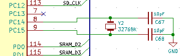

Show relevant parts of your schematic, How are PC13-15 configured?
Oleg Mikheev
PC13 is not connected, PC14 and 15 are connected to RTC oscillator:

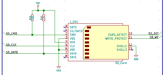

0693W000007DSUNQA4.pngSD card is connected this way
0693W000007DSW9QAO.pngSD_CMD - PD2
SD_CLK - PC12
SD_DAT0 - PC8
SD_DET - PG11 (card present, GPIO input)
SW_WP - PG13 (write protection, GPIO input)
I'm using STM32F407ZGT6 in LQFP144 package
