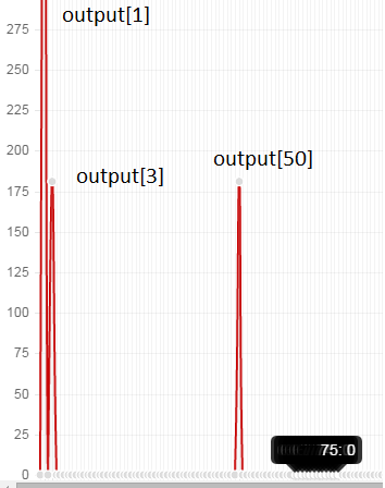

Hello!
I trying to create an aplication with FFT. So, I read 1024 points from internal ADC (12 bit), sampling frequency 1024 Hz. Then I process them with FFT functions from DSP lib STM32Cube_FW_F4_V1.7.0.arm_cfft_radix2_instance_q15 fftInstance;
static
u32 curInputCursor=0;
static
u32 dataIsReady = 0;
static
q15_t input [2048];
/**< input points */
static
q15_t output [1024];
/**< output frequencycharacteristic */
/** @brief Timer interrupthandler. Frequncy = 1024
Гц
extern
''C''
void
timerInterrupt (
void
input[curInputCursor++]=uhADCxConvertedValue;
/**< making 1024 points from ADC DMA */
if
(curInputCursor>=1024)
curInputCursor= 0;
dataIsReady= 1;
HAL_TIM_Base_DeInit(&htim1);
/**< turn off interrupts when all data is ready */
invertLed();
/**< Checking sampling frequency on osciloscope (1024 Hz it's true) */
/** @brief Task with FFTcalculation */
static
void
fftTask (
void
*p)
q15_t maxValue;
/* Max FFT value is stored here */
uint32_t
maxIndex;
/* Index in Output array where max value is */
while
(1)
if
(dataIsReady)
/**< if datais ready starting calculation */
dataIsReady= 0;
arm_cfft_radix2_init_q15(&fftInstance, 1024, 0, 1);
arm_cfft_radix2_q15(&fftInstance,input);
arm_cmplx_mag_q15(input, output, 1024);
u32index;
saveFft();
timInit();
/**< run timer again for next 1024 points */

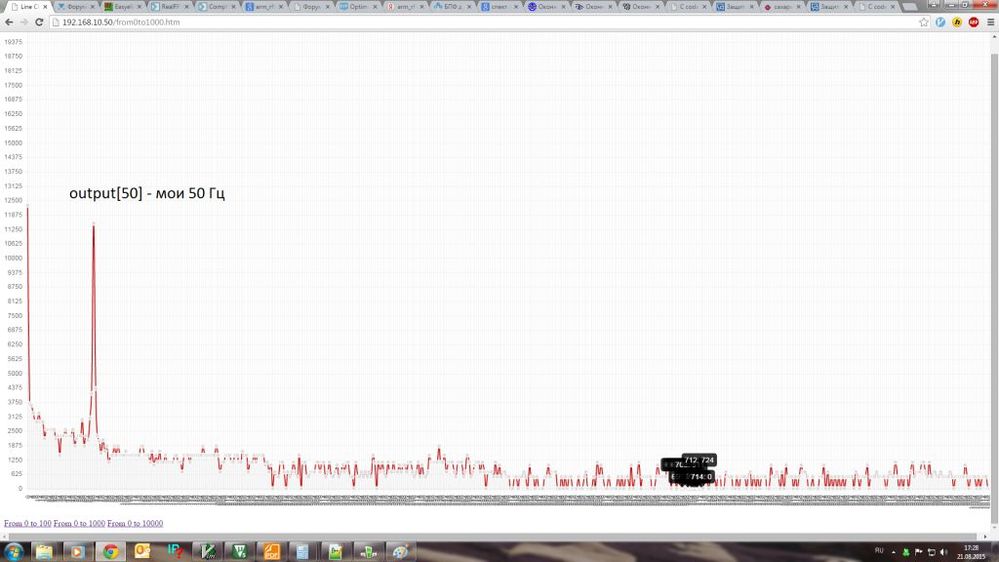

I expect in output[] frequency characteristic with 1 Hz step. output[0] is constant signal, output[1] - first harmonic, output[2] - second and etc. But when I connect 50 Hz 1 V ampl and constant with 1V, I have the follow: output[0] = 0; output[1] = 543; output[3] = 181; output[50] = 181 (picture bellow).- Mark as New

Hi yanikeev.vasilij,
May be you need to fill your input buffer correctly, you can dump the input buffer to verify it.
Insert this code:for (i = 0; i < 1024*2; i += 2)
input[(uint16_t)i] = (q15_t)uhADCxConvertedValue ;
/* delete Imaginary part */
input[(uint16_t)(i + 1)] = 0;
instead of:
input[curInputCursor++]=uhADCxConvertedValue;/**< making 1024 points from ADC DMA */
This may resolve your issue.
**** Please note that the output here is a full FFT (it is a mirror of the harmonics positives and negative ones).
