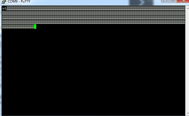

i am new to forum, and also to stm32 discovery. So please some patience :).
I am trying to send from discovery to PC.
Tried with USART6 + UART2USB and in putty on PC everything works.
Then i connected HC-05 to same USART6, just set baudrate to 38400 and tried again.
Everytime i reset whole system (connecting BT, running code) in manage to get 2 character aA but then just ▒  signs. I do not understand, what i missed. My code in bellow. I tried to lower to 9600 without success.
Any idea or advice for lost begginer?

Posted on August 11, 2014 at 16:27
So indicative that the wireless link fails..

Posted on August 11, 2014 at 17:07
Ok, so this could indicate failed connection - means that on discovery would be everything right, i have to find out, why connection fails ...
Just one thing ... I send char every 0,2 seconds to PC- and when connection fails, this should stop ( i think). But every 0,2 i get one
sign. Like discovery is still sending, just something is wrong with data. Is this logical? I do not belive, that putty has some cache and shows randomly. And if i debug step by step when i click next, then i get next char, so putty is still under control of MC.
with regards, Robert

Posted on August 11, 2014 at 18:05
The code is not unreasonable, you could perhaps use 2-stop bits, but I don't think this is a synchronization issue.
You could also use other terminal applications, like RealTerm or TeraTerm.
You could use a scope or logic analyzer, and confirm for yourself that the data coming out of the STM32 is correct. You could also fork the TX output and connect that via a USB-to-CMOS-Serial adapter in addition to the BlueTooth route.
stm32forum
Posted on August 11, 2014 at 22:05
Default baudrate is 9600 unless you have changed it with the AT commands or pin34 is at high level.
