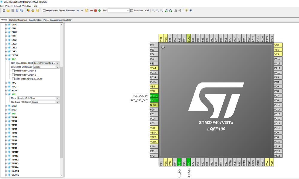

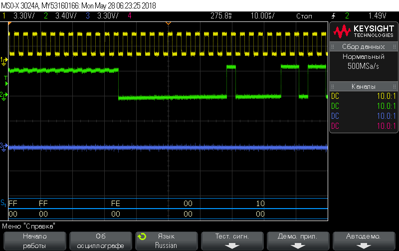

Im trying to catch data from the unknown device, this device has data and clock. I decided to make my stm32 as spi slave and catch the data as recevier.And im struggling with it. I have this data flow which i want to catch:
Clock is yellow and green is data.
I need only 16bytes from it, when data line goes low, we can see this 16bytes:
And there is the speed of the clock, as you can see its around 1.5us each clock pulse. So what i have to do is configure spi with HAL, i toolk SPI1(PA5 - CLOCK, PA7- DATA) cuz it has more powerful MHZ, chose spi mode ''RECEIVE ONLY SLAVE'', HARDWARE NSS SIGNAL: DISABLED. And here is my spi1 config:

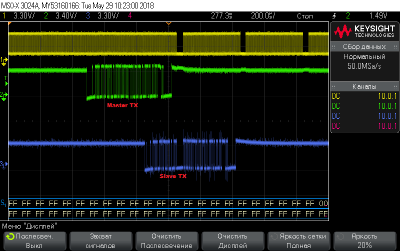

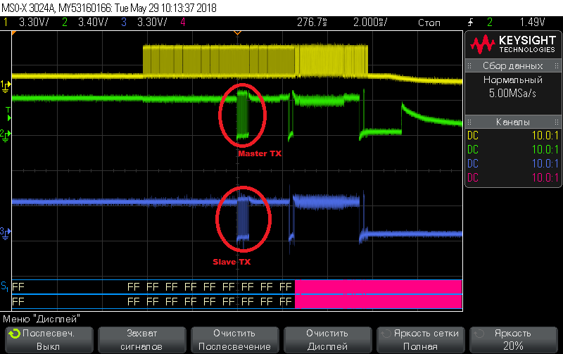

i managed to synchronize slave and master with HAL function:
HAL_SPI_TransmitReceive(&hspi1, (uint8_t*)spi_buffer, (uint8_t *)spi_buffer, 16, 2000);
Im sending from slave the bytes which i get from master, in purpose of debugging, and the data is same, so its perfectly synchronized and seems like slave reading all data master sends. Here is the images:
1) Slave is my STM32f4 and master that i catching, its the same
2)Zoomed up
The problem is that i dont know how to read that data, its 16bytes which i need somehow to read without slowing the spi down. All my attempts to do that are failed. The whole code are:

The important fact that the beggining of the messge i want to catch is always starts with 0xFE0010, so after those bytes i need to read next 13bytes

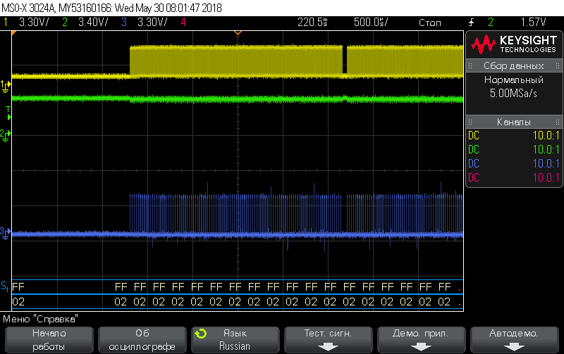

Okay, the  HAL_SPI_TransmitReceive is really strange for me. for exmaple if i use  HAL_SPI_TransmitReceive(&hspi1, (uint8_t*)spi_Txbuffer, (uint8_t *)spi_Rxbuffer, 16, 2000);
  outside of while(1) it should read 16bytes from master when it get first clocks and send 16bytes to master, this is how i see it. But what excatly i got 0690X00000602WSQAY.bmp
I used diffrent buffers as T J suggested, so tx_buffer sending 02 on every clock, why does it happening if i inisialize get and send 16bytes only once.

Posted on May 30, 2018 at 09:02
What did you receive in the RXBuffer ?

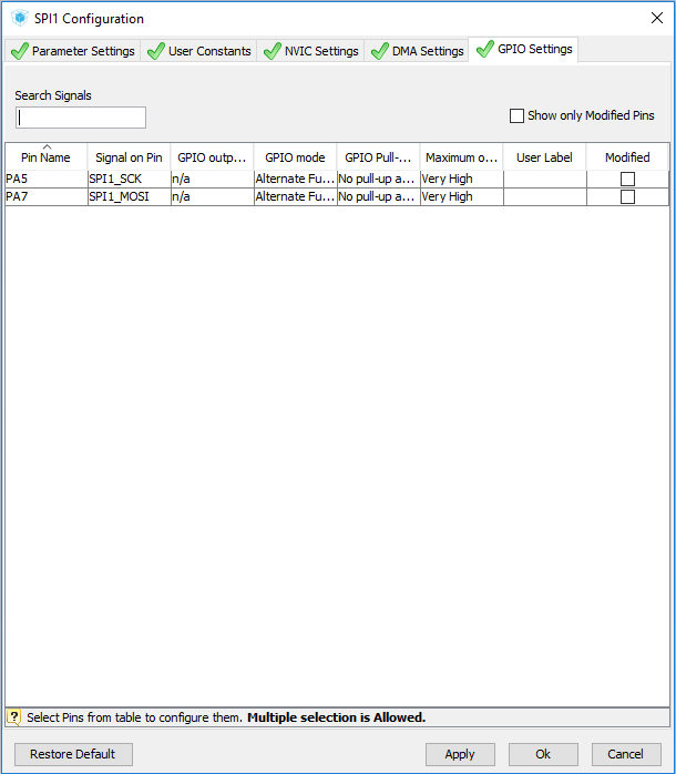

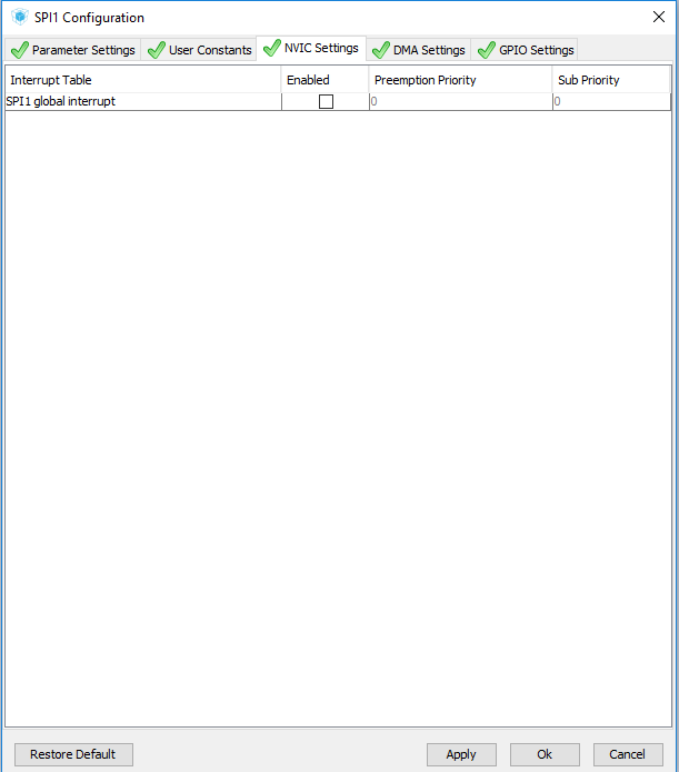

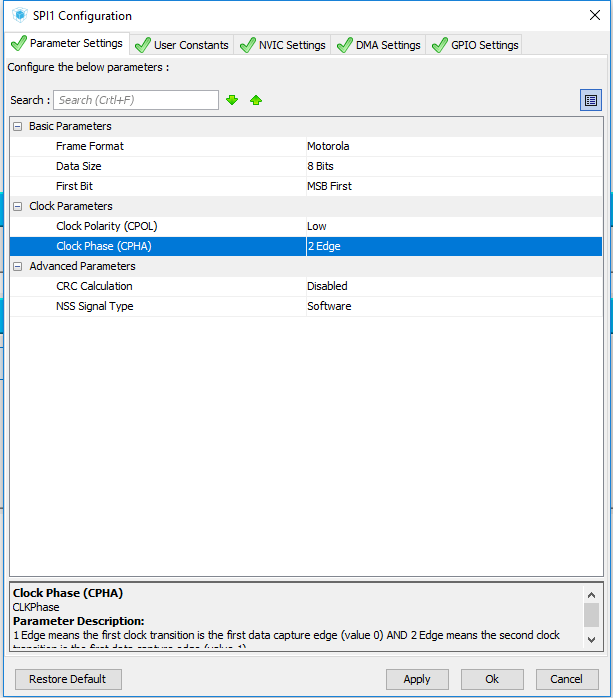

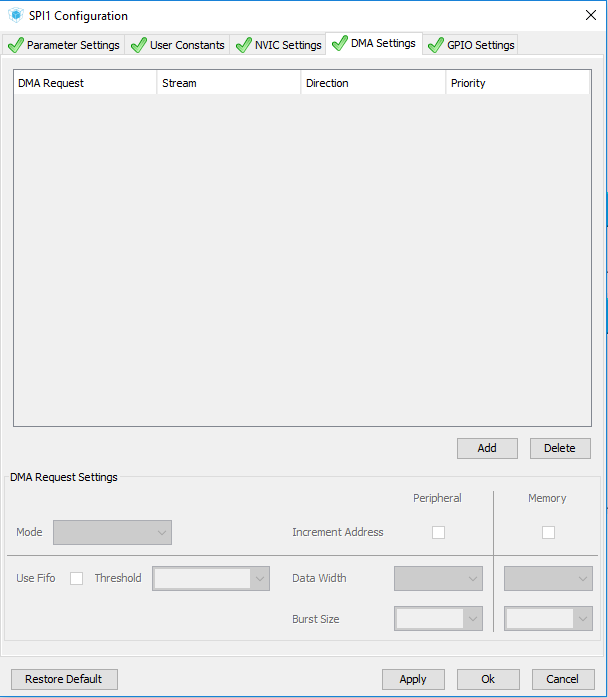

Posted on May 31, 2018 at 04:34
Yes Cube, i keep it simple: no dma no interrupts
0690X0000060L1WQAU.png0690X0000060L1vQAE.png0690X0000060L1qQAE.png0690X0000060L20QAE.png0690X0000060KtZQAU.png0690X0000060L21QAE.png
I chose CPOL low and CPHA 1 edge, because seems like master works in MODE 1, here is FE0010 data:
Posted on May 31, 2018 at 12:25
debugger shows me that we stuck at while (!(hspi1.Instance->SR  & SPI_FLAG_RXNE))
and Disassembly shows  0x8000D24 688A       LDR           r2,[r1, &sharp0x08].
But data is comming, RXNE flag should be SET
