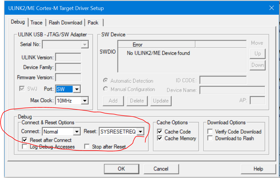

The error 'SWD Communication Failure' is showing when I look at setting under 'Debug' in the 'Options for target...'.

‎2018-03-03 11:44 AM
Hello
Here is an answer I received from Hans, one of the Keil engineers:
The TRST signal was never really necessary. It exists on many ARM7/9 and also Cortex-M3/4 devices but it is only available in the old 20 pin JTAG connector. The newer 10 pin Cortex and 20 pin Cortex+ETM connectors do not contain this signal. There are newer devices (especially Cortex-M0) which only have a SWD (no JTAG) interface and they don?t have a TRST signal at all. So one can leave this signal off. This saves one pin.
uVision uses the methods to RESET the part: you can select them here:
A ULINK D is a ULINKpro without ETM instruction trace. SWV works fine.
