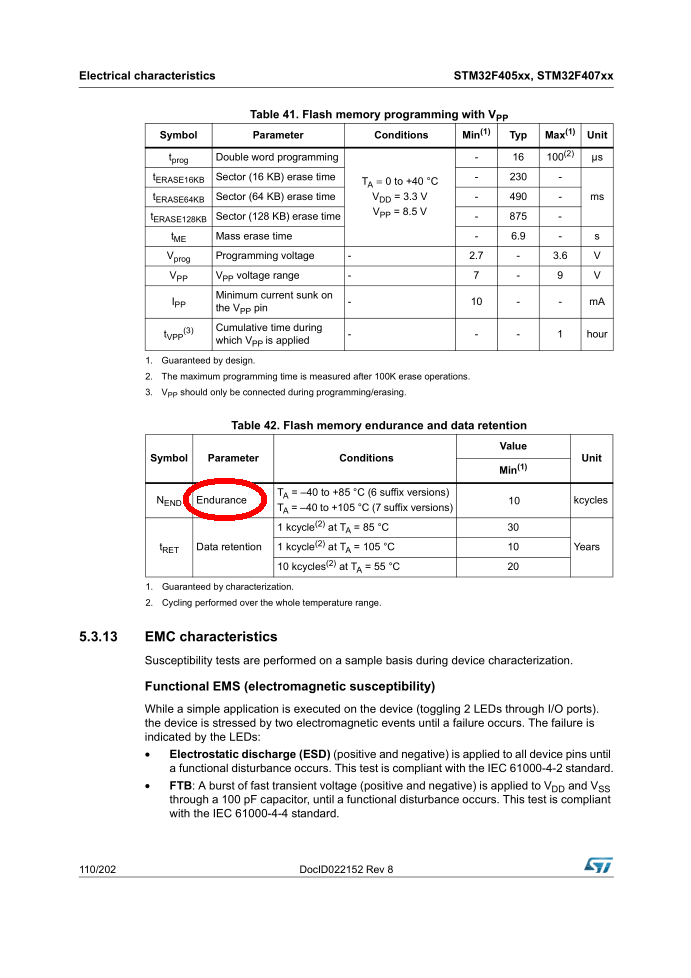

STM32F405VGT7 Flash memory write endurance : how many times can the internal FLASH be written / erased?
Options
‎2018-08-17 2:36 AM
Either I checked the wrong datasheets, use the wrong keywords, am blind or the answer is in a source I didn't find or check.
Please help

‎2018-08-17 3:16 AM
Source: STM32F407 datasheet.
Keyword: endurance.
Options
‎2018-08-17 6:00 AM
oh, Thanks a lot.
don't know​ how I could miss this when I had it in front of me.
