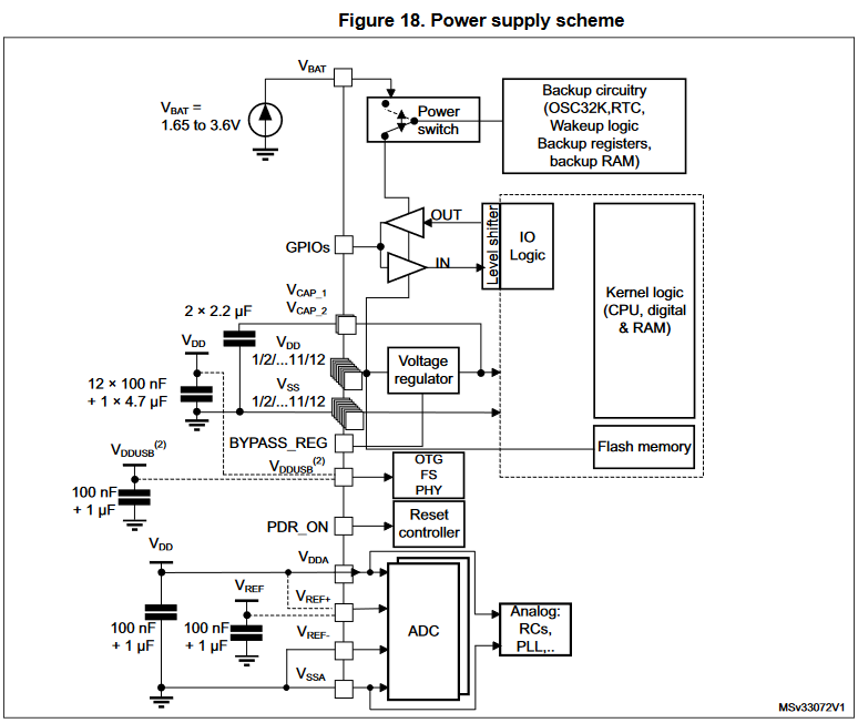

I use this Power supply scheme:

Did you check the corresponding channel for timer 2 in datasheets?
‎2023-06-24 10:25 AM
Dear @Sem486 ,
I would recommend first to check hardware schematics and then power and clock settings
One is QFN48 pin running up to 84MHz and F446 is LQFP64 running up to 180MHz . Power pins , VCAPs , VOS level I see that both in code above running from HSI with PLL at 84MHz and using VOS3 .
hope it helps you , Ciao
